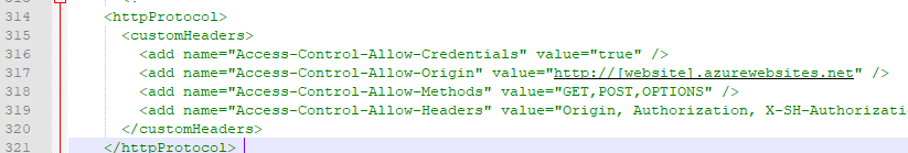

Enable CORS
  1. Navigate to your SmartHub installation root directory.
  2. Open the file web.config for editing.
    1. Enable CORS by uncommenting the section for cross-domain requests, around line 312, currently.
    2. Change the value of the parameter Access-Control-Allow-Original, currently around line 314 to the value of your WordPress instance.
      1. For example, https://myWordPressinstance.com
    3. Remove the X-Frame-Options and Content-Security-Policy headers.
