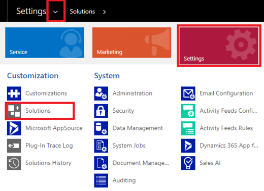

  2. Navigate to your Dynamics → Settings → Solutions page.

  1. Navigate to your Dynamics → Settings → Solutions page.

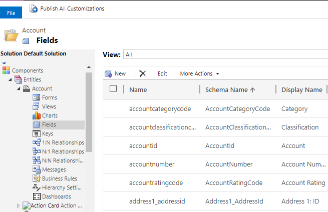

  • To find the required object and field go to:
    • Settings → Customizations → Customize the System → Open up the Entities drop down → Open up the required object drop down → Click the fields button.
account.name,contact.firstname
How to See All Configurable Entities
  1. Navigate to Dynamics → Settings → Customize the System.
  2. On the left side menu, under Components, expand the Entities.
  3. Expand the desired entity, click on Fields to see all properties for an entity.

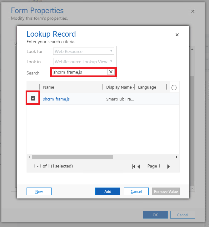

  3. On the Form Properties → Form Libraries add the shcrm_frame.js.

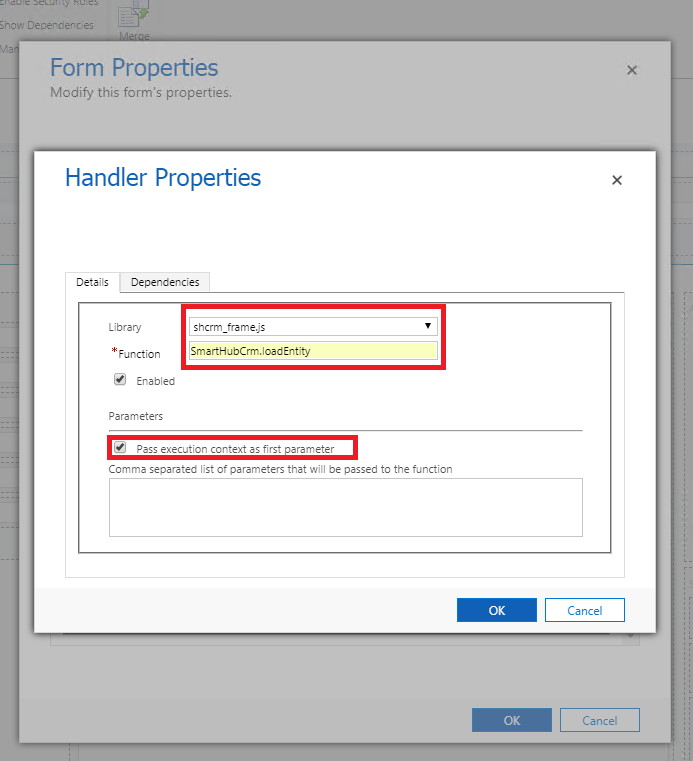

  4. On the Form Properties → Event Handlers add as a Form control and OnLoad event the SmartHubCrm.loadEntity function from shcrm_frame.js library and check Pass execution context as first parameter.

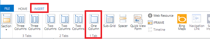

  5. Insert a new One Column Tab on the page.

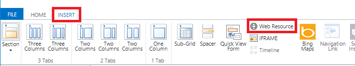

  6. In the new Tab created insert the shcrm_frame.html as a Web Resource.

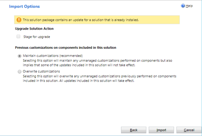

  2. Click on Import and select the new zip archive with the solution to upload.
    * Be sure to check Maintain customizations in case you customized the Hub before.
