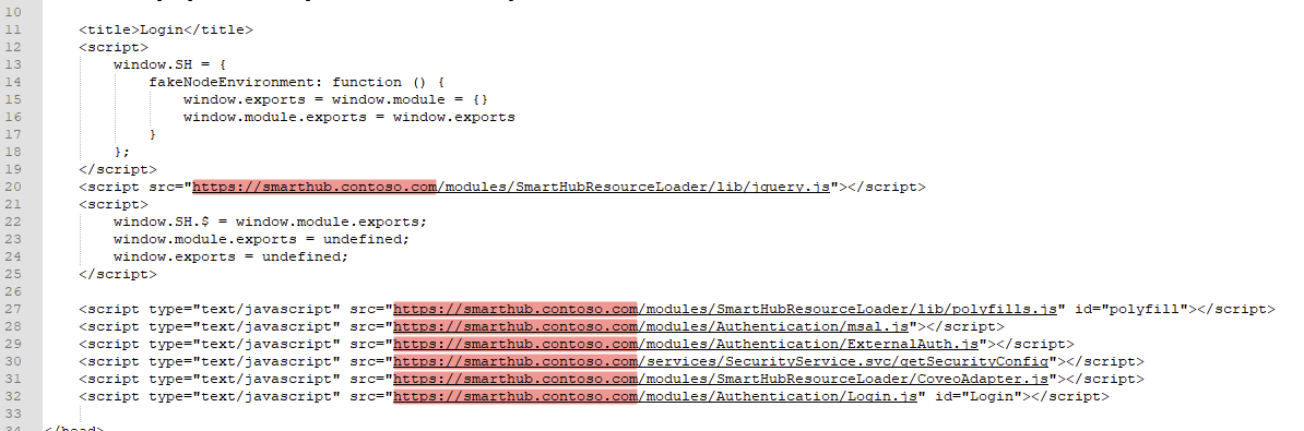

  3. Navigate to the SmartHub installation directory and copy the file Login.aspx to a different directory (for editing).
  4. Open the copy of the file Login.aspx for editing.
  5. Remove the first line (that starts with the <%@ Page directive).
  6. Update the src attribute for all the script tags: prefix the path with the full address to your SmartHub site (https://yoursite.com) as shown in the example below, (which uses the sample site https://smarthub.contoso.com):

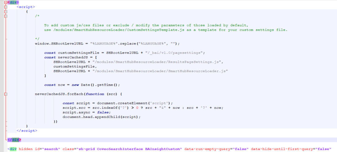

  12. Edit the file SPOEmbed-Results.html and make the following changes:
    1. Remove all the non-script tags from the head and everything above the <head> tag.
    2. Replace the <head></head> and <body></body> tags with <div> and </div> while keeping the inner contents of those tags:
    3. For the DIV with ID "search" add a new attribute data-main="true"
    4. Replace the src attribute of logo with absolute URL.

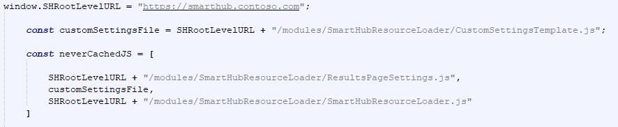

    5. Change the SHRootLevelURL value to your SmartHub root address, as shown below:

      3. The SPOEmbed-Results.html page should be reassembled as follows:
        Info: Notice that "/customer/CustomResultsPage.html" is the relative URL of your custom results page.

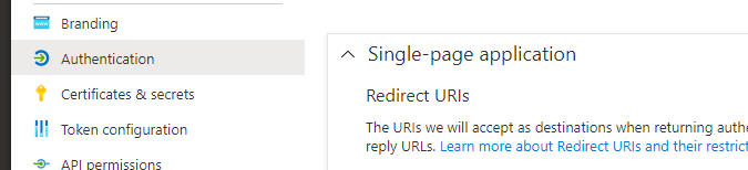

  3. Navigate to the Azure Portal App registration used by SmartHub authentication.
  4. Edit the list of Single-page applications (under Authentication).
    1. Add the URL to the Login.aspx page you uploaded to SharePoint, such as https://customer.sharepoint.com/SitePages/Login.aspx
