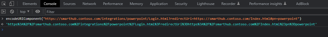

URLs can be encoded by opening a Browser Console (F12) and applying encodeURIComponent function to desired URL:

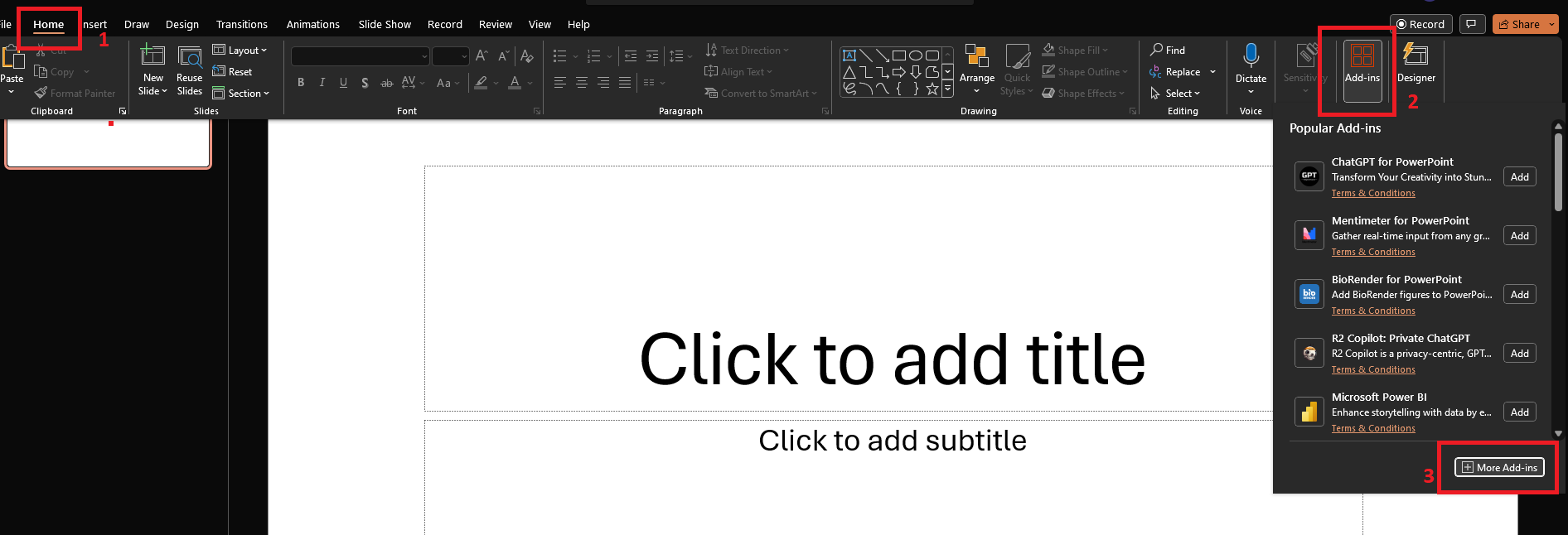

How Users Enable SmartHub in PowerPoint
  1. Users can enable SmartHub in their PowerPoint instance by going to Home > Add-ins > More Add ins > Admin managed and add "SmartHub ".
  2. The SmartHub button can be found in PowerPoint > Home > Show SmartHub.
