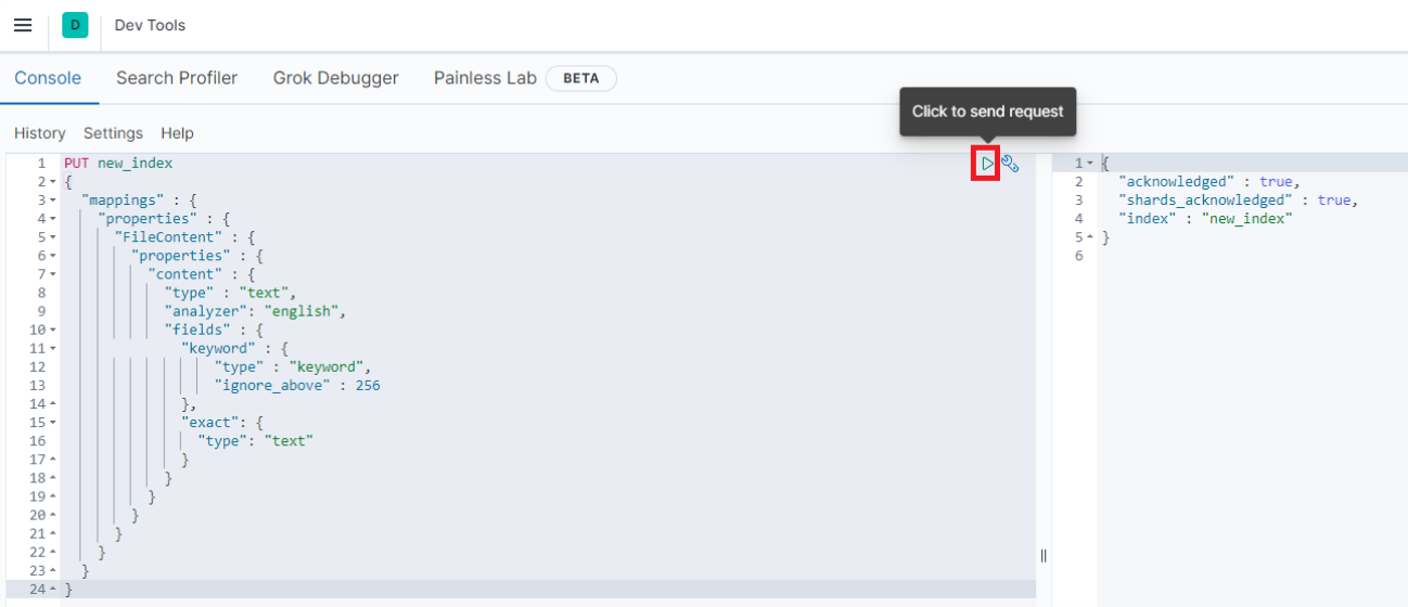

  4. Create a new Elasticsearch index by using the following code snippet, with the following adjustments:
    1. Replace new_index_name with the desired name for the Elasticsearch index.
    2. Specify the field(s) which should use a different analyzer.
      1. In the code snippet below, the content property of the FileContent property will use a custom analyzer.
    3. Replace your_analyzer_name with a build-in analyzer (for example the language analyzer english) or a custom analyzer.
    4. Add the exact field if you want to have exact matches on that property.
      PUT new_index_name
        "mappings" : {
          "properties" : {
            "FileContent" : {
              "properties" : {
                "content" : {
                  "type" : "text",
                  "analyzer": "your_analyzer_name",
                  "fields" : {
                    "keyword" : {
                        "type" : "keyword",
                        "ignore_above" : 256
                    "exact": {
                      "type": "text"              }
  5. Run the command.
