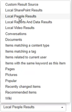

  • Entity record result source
    • The result source to pick entity records from
  • Related record result source
    • The result source to pick related records from
