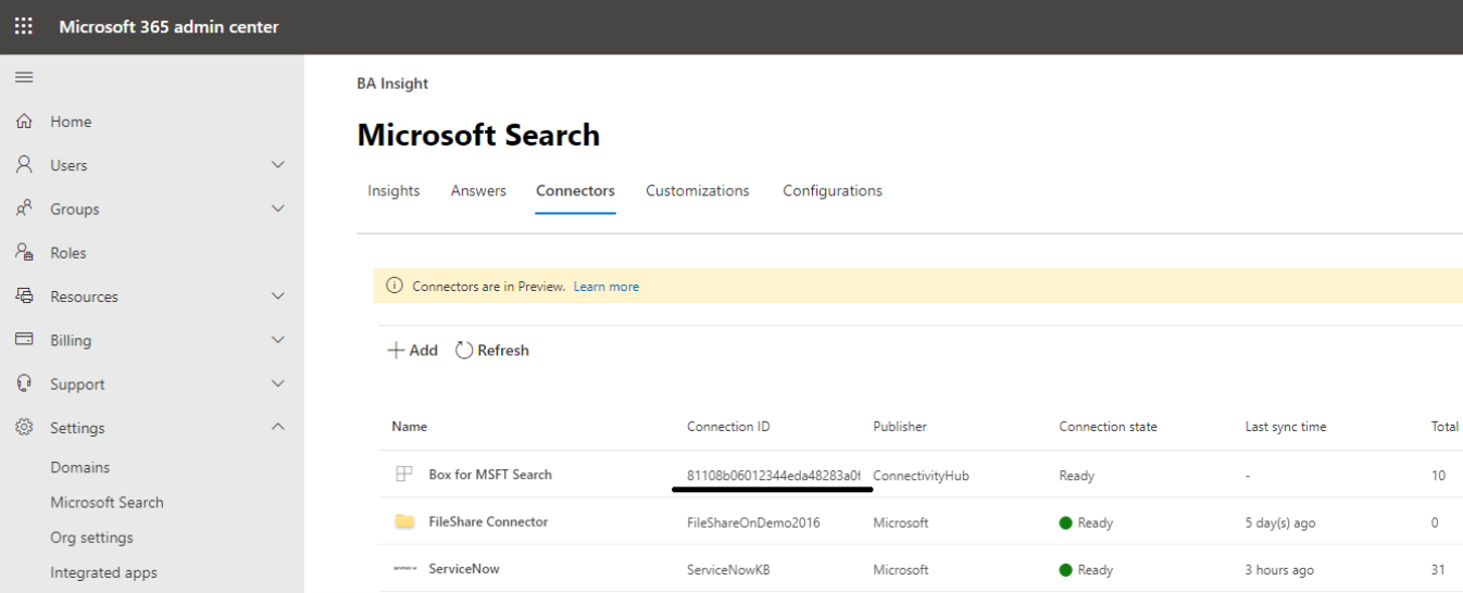

- To find the connector connection ID, do the following:
- Go to the Office Admin page
- Click Settings > Microsoft Search.
- Click Connectors
- A list of your current connectors appears with their Connection IDs. See the graphic below.
- The connection ID value is the parameter the search engine expects to receive.

- To get the connector Connection ID:
- Go to Settings → Microsoft Search.
- Go to Connectors
