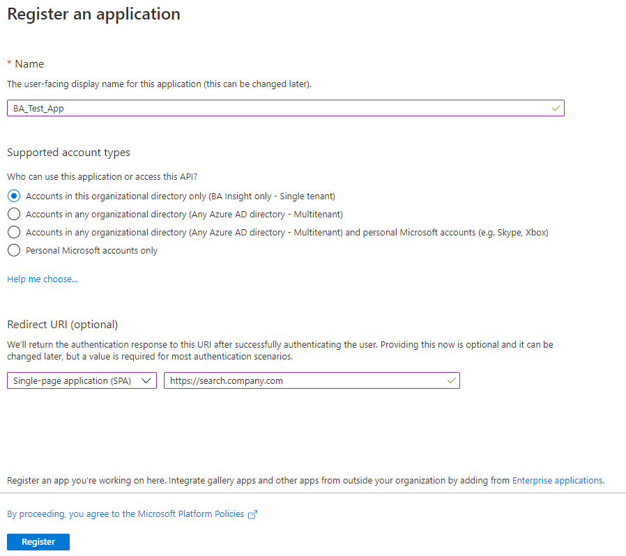

The following procedure registers your SmartHub application for SharePoint Online in Azure. This is required to use SharePoint Online as a results search engine in SmartHub.
- Login to your Azure portal as an administrator: http://portal.azure.com
- Click App registrations>New registration.
- Enter the new application details:
- Name: Smart Hub App for SP Online
- Supported account types: Sets the API access by account.
- Redirect URI:
- Select Singe-page application (SPA)
- Enter Your SmartHub URL home address (for example, https://search.company.com)
- Click the Register button at the bottom of the screen.

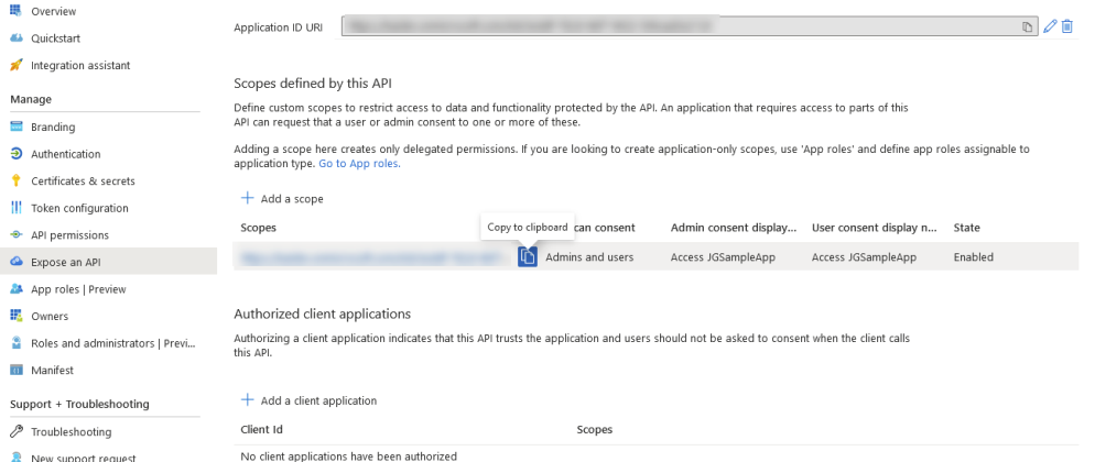

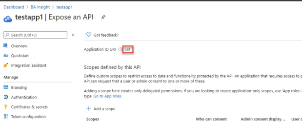

- Create the App ID URI.
- Click Expose an API section on the left side navigation menu.
- To manually set your App ID URI, click Set at the top of the page.
- To set your App ID URI automatically, continue to add a scope, below.

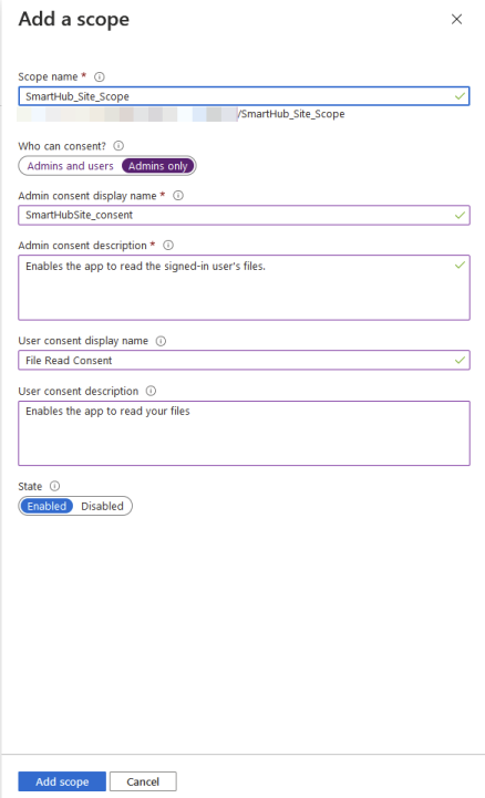

- Click the Add a Scope button.
- In the window that appears, note the Application ID URI is shown below the "Scope name" field (with the field empty). Configure a scope to be used by SmartHub to provide permissions-based access to its resources.
Scope name: Enter a scope name
Who can consent: See here for more information.
- Admins and users - Every user can themselves consent; they will see the message to “SmartHub wants to sign in as you”.
- Admins only - Admin consent serves as pre-consent for all users.
Admin consent display name: Enter a consent display name.
Admin consent description: Enter a description for the Admin consent.
User consent display name: Enter a name for the user consent.
- User consent description: Enter a description for users consenting to the API.
- State: Enable or Disable the scope. This can be changed as needed.
- When done, click Add scope.

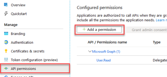

Add Permissions
Add permissions for the application:
- Click API permissions > Add a permission.
- If not already present add the Microsoft Graph user read permission.
Click Select an API>Microsoft Graph>Delegated>User.Read. - Add the following permissions by selecting API > SharePoint>Delegated.
(Select "APIs my organization uses" as a shortcut, if you desire). - User.Read.All
- Read user profiles
- Sites.Search.All (Required only for the SharePoint Online search engine)
- Run search queries as a user
- TermStore.Read.All (Required only for the SharePoint Online search engine)
- Read managed metadata
- Click Add permissions when done.

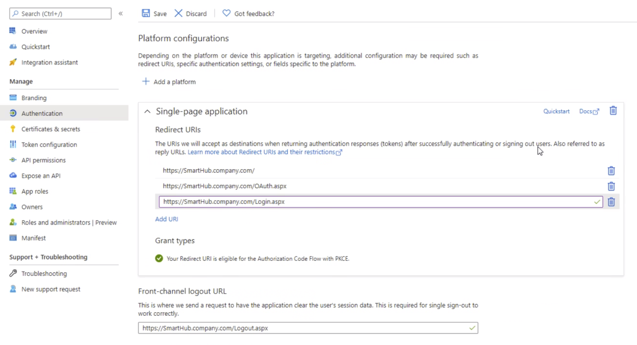

Redirect URIs
Enter app Redirect URIs (previously called Reply URLs).
- Click Authentication from the left-side navigation.
- Click Add URI under Single-page application in the middle of the screen
- Enter <your app Redirect URIs> in the format: https://search.company.com/(OAuth/Login).aspx
- These addresses must start with https
- These addresses are case-sensitive.
- You must enter both Login and OAuth URIs.
- Logout URL: Enter the log-out URL in the format: http://search.company.com/Logout.aspxIf you have existing Redirect URIs, recreate them anew instead of migrating them to the single-page application (SPA) platform configuration.
- Click Save at the top of the page.

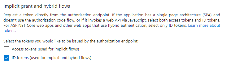

Implicit Grant
If you use a SharePoint Online search engine enable Implicit Grant for ID tokens:
- Scroll down to Implicit grant and hybrid flows.
- Ensure that the ID tokens option is enabled.

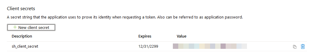

Generate a Client Secret Key for Your App
You need the client secret if you either:
- You use Azure AD as the user profile provider in SmartHub
- You have a SharePoint Online search engine configured.
- Click Certificates & secrets>New client secret to generate a client secret key for the app.
- In the window that appears (shown below) enter the following information.
- Description: Enter a name for the client secret. (Note: The name is your client secret).
- Expires: Select Never expires.
- A Value is generated after you click Add.
- Copy the new client secret value. You cannot retrieve the secret value after you perform another operation or leave this page.
- Click <YourApp > Overview and make a note of:
- Application ID: This is the "Client ID" that needs to be configured in the SmartHub Admin page.
- Tenant ID (optional): This is the Tenant name or ID is entered in the SmartHub Admin page.

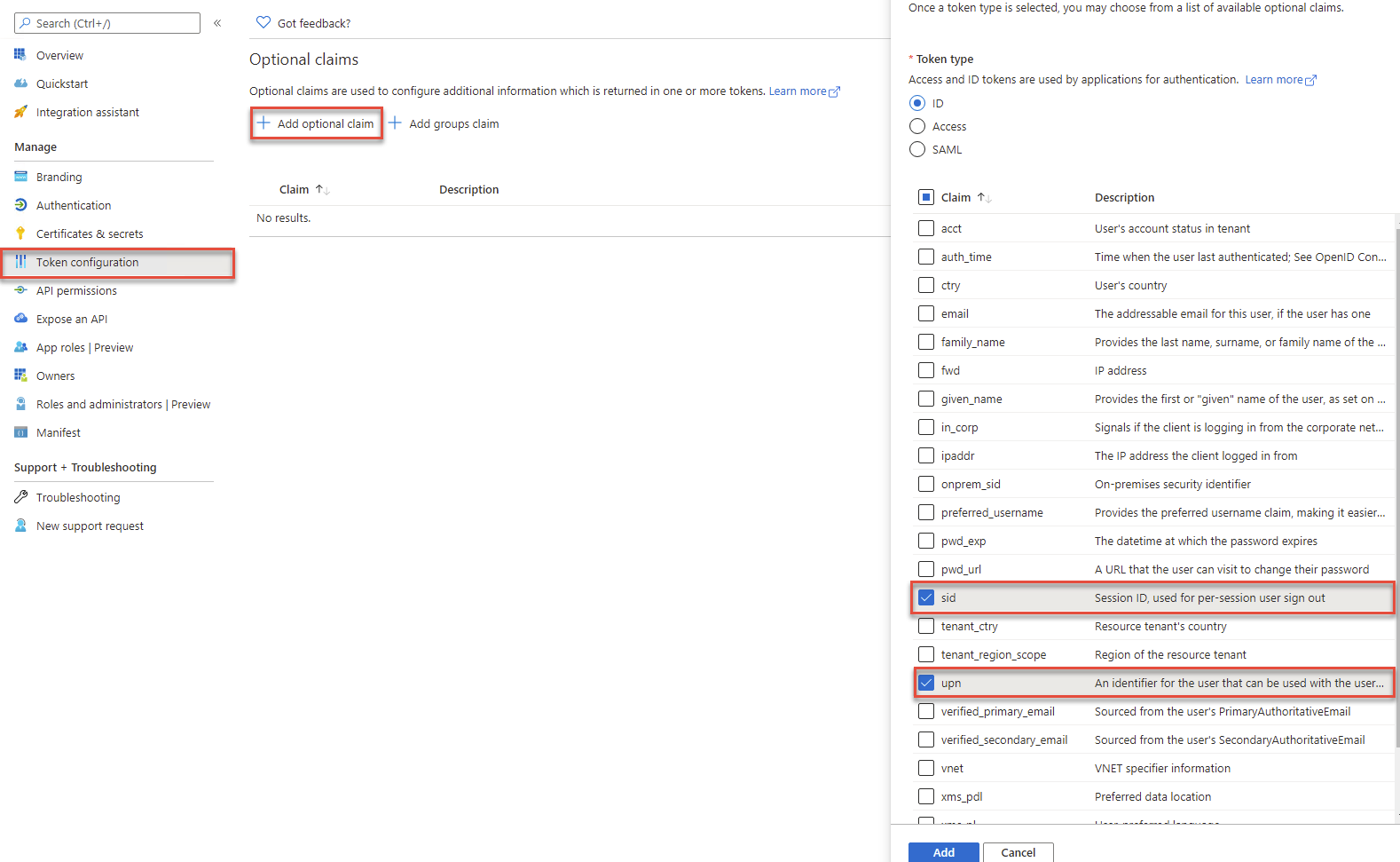

Token Configuration
- Select Token configuration from the left-side navigation.
- Click Add optional claim.
- Select ID as *Token type.
- Select upn and sid under Claim.
- Click Add.

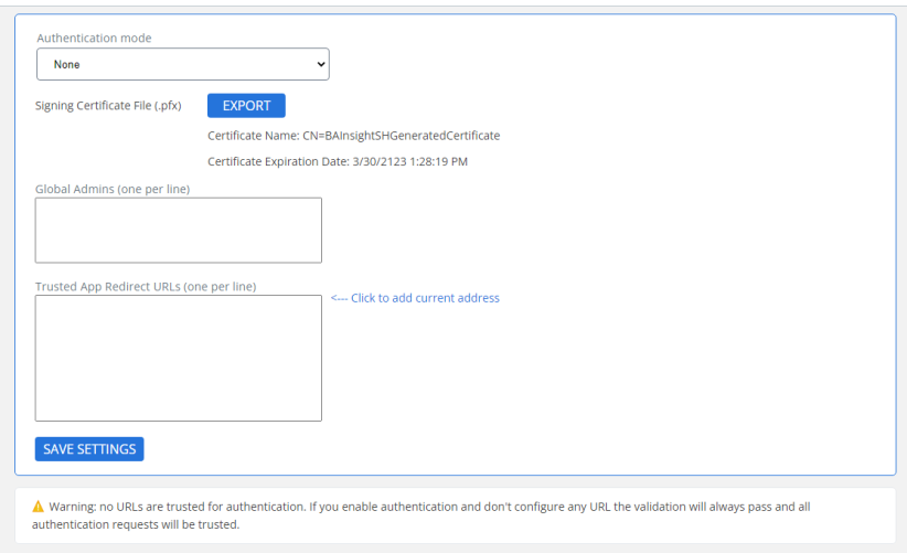

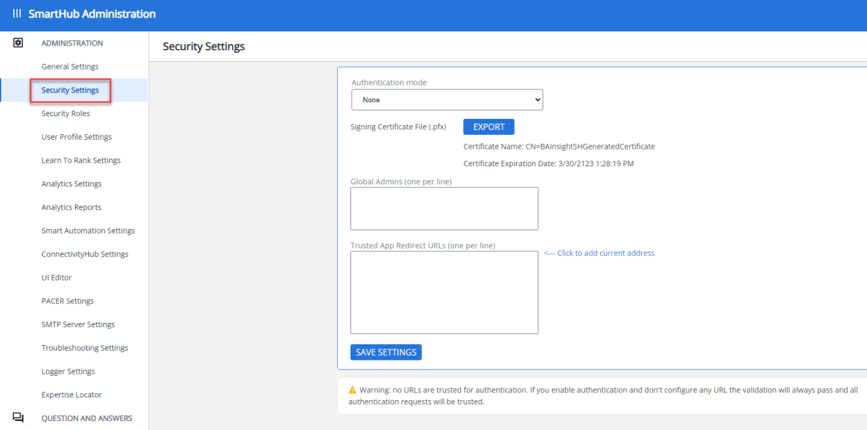

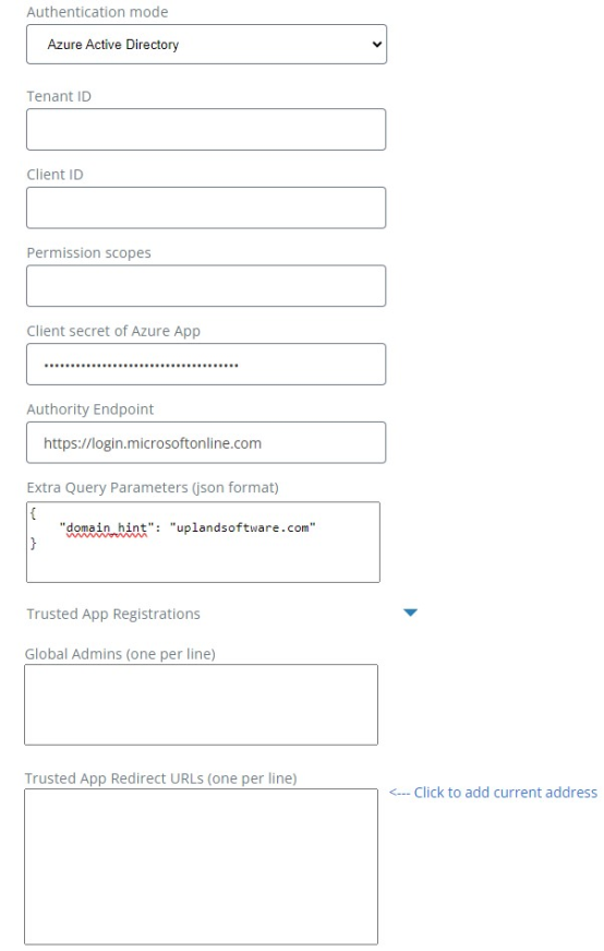

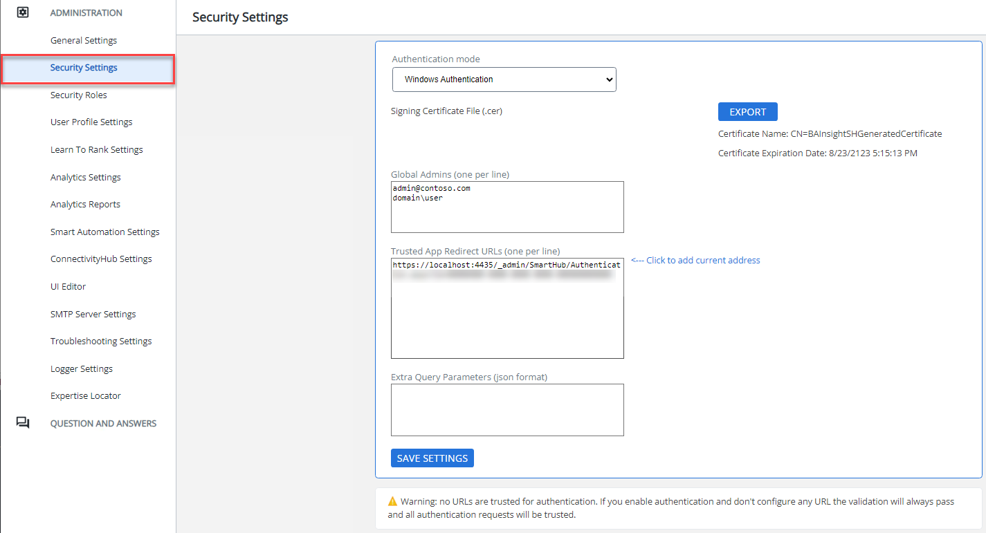

Enter Your Authentication Settings (Azure AD) in SmartHub
- Navigate back to the SmartHub Administration page by going to the
_ADMINfolder and navigating to the SmartHub admin User interface (UI). Alternatively, enter: http(s)://[web-app-url]/_admin - Select Security Settings.
- Authentication mode: Select Azure Active Directory.
Tenant name or ID (required): Specify your Azure tenancy name in this format ("contoso" is BA Insight's fictitious example domain):
contoso.onmicrosoft.com
orEnter your tenant ID
- Client ID (required): The "Application ID" as shown in the Azure Portal App Registration page for your application.
- Enter permission scopes for Azure App separated by comma: Paste in the custom scope defined in your Azure App from the "Expose an API" section. See the screenshot below.
- Client secret of Azure App: Enter a client secret if you have configured a Sharepoint Online search engine.
Authority Endpoint: The authority is a URL that indicates a directory that MSAL can request tokens from
Extra Query Parameters (Optional): You can add extra query parameters before doing the MSAL authorization request. For example you can specify a domain hint for MSAL to use.
Trusted App Registrations: In case that, you need to use another app between SmartHub and App used for authentication, you need to add a Trusted App Registration.
Navigate to Azure APP → API Permissions → Add a permission → My APIs → Select your app used for Authentication in SmartHub → Choose Scope used in SmartHub for Authentication
Client ID: The "Application ID" as shown in the Azure Portal App Registration page for your application
Client Secret: The Client secret generated for your app
- Admins users (one per line): The local administrator account(s) email address (username@domain.com). Enter one user account email address per line.
- Trusted App Redirect URLs: List of application URLs that use SmartHub to validate the user's credentials.
- This also includes custom DNS names used for the server hosting SmartHub.
- All BA Insight applications integrated with SmartHub are listed here.
- For example, see the following application URLs (some optional):
SmartHub site URL: The SmartHub site address, as accessed by users.
Note: You must list any registered DNS names that access your SmartHub server. Otherwise, users will not be able to authenticate with SmartHub.Smart Previews site URL: Optional. The Smart Previews site address, as accessed by users.
ConnectivityHub site URL: Optional. The ConnectivityHub site address, as accessed by users.
Custom apps: Optional. The URLs of custom applications that are integrated with SmartHub.
"domain_hint": "yourCustomDomain.com"

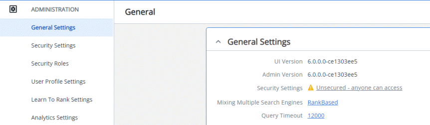

} - Click Save to return to General Settings to see the "Security settings: Secured" message.

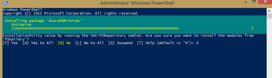

- Open a Windows PowerShell with Administrative privileges.

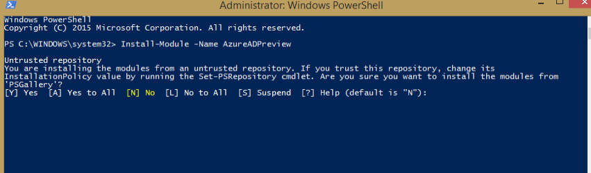

- Install the AzureAdPreviewModule with the command
Install-Module -Name AzureADPreviewas shown below:
- Enter "
[A] Yes to All". - The package installs.

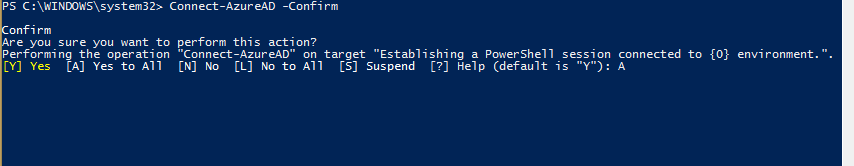

- Connect to Azure AD with the command
Connect-AzureAD -Confirmas shown here:

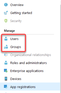

Restrict Access to SmartHub from Azure
Active Directory Authentication
If the option for user assignations is enabled (see here for more info), then everyone under the "Users" and "Groups" list in the App registration in Portal (portal.azure.com) has access.
- Azure Active Directory enables you to restrict your SmartHub site (app) to a set of users by following these instructions: https://docs.microsoft.com/en-us/azure/active-directory/develop/howto-restrict-your-app-to-a-set-of-users.
- Any user not assigned to the app cannot access it.
- Users, by name, are not strictly denied.
- Any user not specifically assigned access is denied.

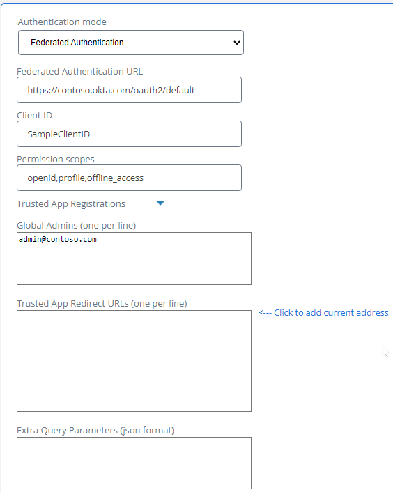

Option 2: Federated Authentication
Use the following information to configure Federated-type user authentication in SmartHub.
About Federated Authentication
SmartHub supports Federated-type authentication, which is any authentication service that is OAuth 2.0 compliant.
Supported identity providers include:
- Microsoft ADFS
- Okta
- Auth0
- others
Your Authentication Service must be configured using OAuth 2.0 with JWT tokens.

- Make sure your Federated Service includes the UPN property in its claims for the user.
Click Save and return to General Settings to see the "Secured" message:
Example Identity Provider: Okta
The following example describes how to configure Okta as your identity provider.
Note: You must have access to your Okta application settings on the Okta website.
Tenant Name is not required.
- Select Federated Authentication
- Federated Authentication URL
- URL of your Okta Authorization Server: the server configured with the UPN claim in the ID token for the open ID (or All) scope
- For example: https://<tenant>.okta.com/oauth2/default
- See the example screenshot below

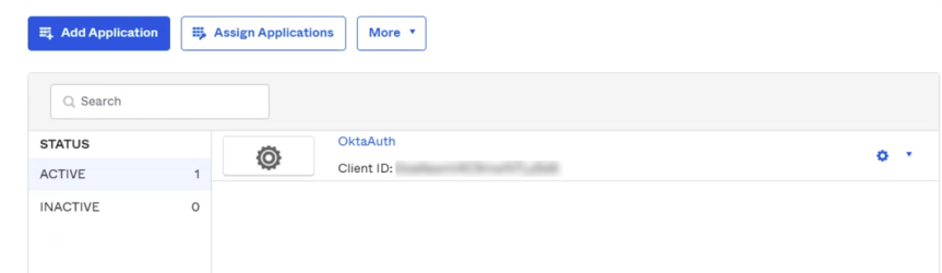

- Client ID
- The active application Client ID, which can be found from the Applications page of the Okta web site. See below.
- Signing Certificate File
- Global Admins (one per line)
- List of users to enjoy administrative rights to your SmartHub site. See Step 8, above.
- Click the link to the right of the field to add the current address.
- Click Save when complete.

- Click Save to return to General Settings to see the "Secured" message.

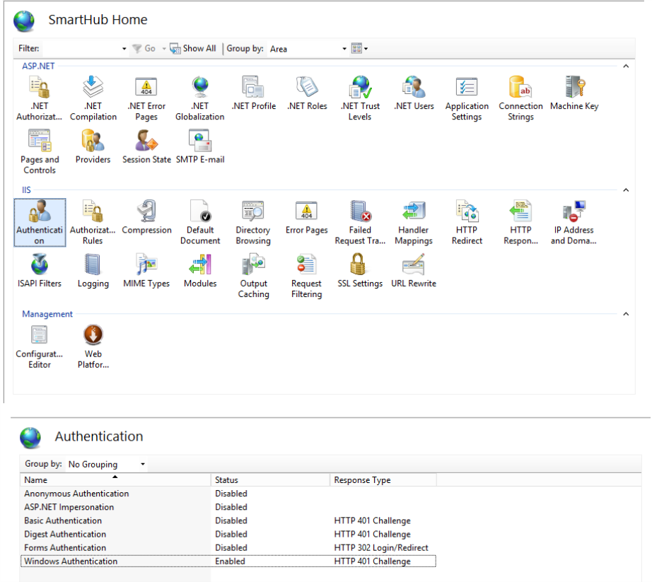

Set Your SmartHub Site to Use Windows Authentication

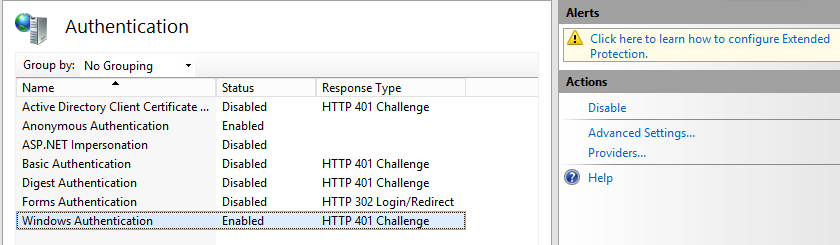

- Edit your SmartHub site in IIS Manager.
- Select IIS>Authentication.
- The Authentication window appears:
- Anonymous Authentication: MUST be set to Disabled.
Windows Authentication: MUST be set to Enabled.
Everyone that is configured in IIS under “Authorization rules” has access.
Authorization rules are located next to "Authentication" from the IIS SmartHub site screen.

Option 4: None (No Authentication)
Use the following instructions to disable authentication to your SmartHub site by using the authentication mode "None".
If you set your SmartHub Authentication mode to "None", everyone has access to the SmartHub site.
BA Insight does not recommend this setting for security reasons.
- Admin users (one per line): Enter the list of users to enjoy administrative rights to your SmartHub site.
- 'Anonymous' may be entered, but it is not recommended for security reasons.
- Groups are not supported.
- Typically, Admin users are set as the local farm account, SharePoint service account, or both.
- User credentials must be entered in the format Domain\username or Username@domain
For example:- Domain50\User12
- UserSmith@contoso.com
- Trusted App Redirect URLs (one per line)
- Click the "<—Click to add current address" link on the page to enter your SmartHub site URL if it isn't currently there.
- You also enter the address (URL) of your SmartHub Analytics site.
- Click Save to return to the General Settings menu to see the "Secured" message.

Use the following procedure to specify which of your users will enjoy administrator rights to the Administrator Console.
- Navigate to the SmartHub Administration page by going to the
_ADMINfolder and navigating to the SmartHub admin User interface (UI).- Alternatively, enter: http(s)://[web-app-url]/_admin
- Security Settings: Click "Security Settings" and the Authentication settings page appears.
Admin users:
This is the list of users that have access to this Admin site.
Enter the users who can access the Administrator console, one user per line.
If "Anonymous" is entered, or no admin users are selected, everyone is treated as an authorized user.

- Click the Save button and return to General Settings to see the Security Settings: Secured message:
