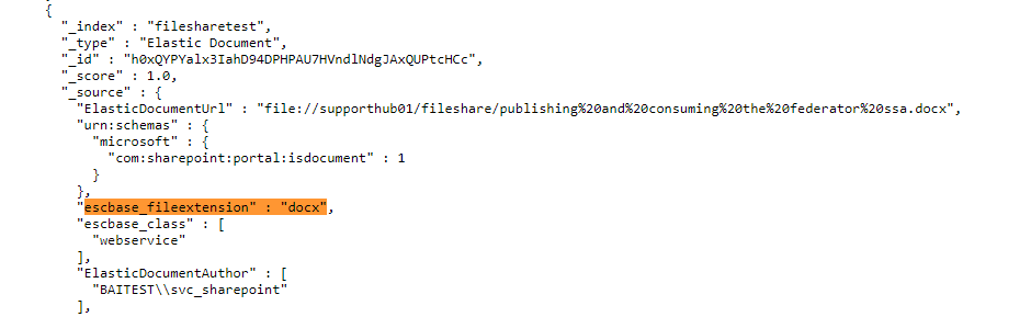

Example Index
The search index (backend) in this example contains the following properties:
- ElasticDocumentUrl
- escbase_fileextension: This is the only property mapped in this specific example.

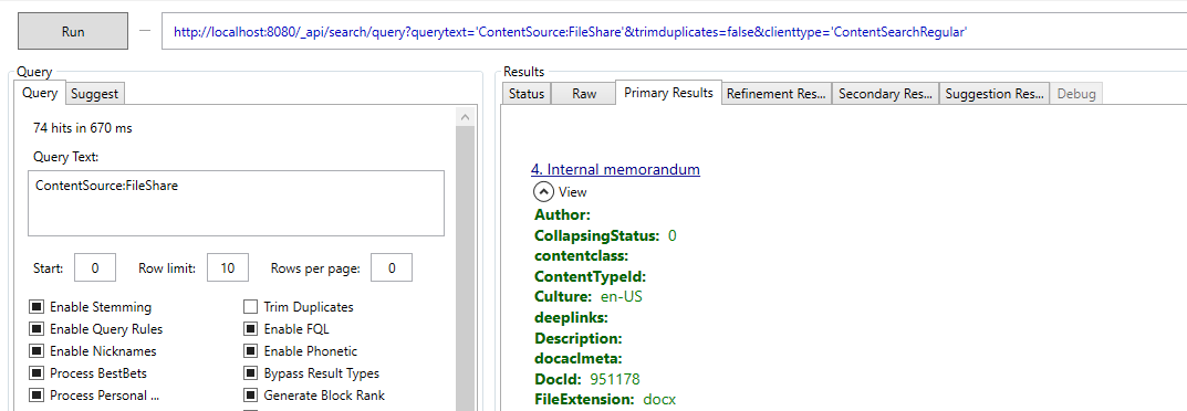

Example Query
To map the properties in this example correctly, you must specify the following Property Mapper configuration:
FileExtension,escbase_fileextension
