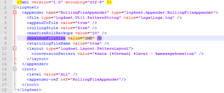

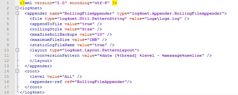

Use the Logs
After you run the BAInsight.PortalAnalytics.DeleteByQuery.exe, the following folder appears ...\Tools\DeleteByQuery\Logs.
Use the LogConfig.xml file in this folder to edit the query in the BAInsight.PortalAnalytics.DeleteByQuery.exe.config file:
  1. To delete the results retrieved from querying all use the following code:
    <add key="DeleteByQuery" value="all" /> <!-- Query to delete by from Elastic Index →
  2. To change the maximum file size, change the code <maximumFileSize value=""/> as shown in the following example:
