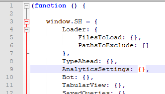

  1. Open DefaultModuleSettings.js, located at <SmartHub_install_dir>\modules\SmartHubResourceLoader\.
  2. Go to the file and scroll down to customProperties, around line 9.
  3. Enter the name of your custom properties into customProperties:"",. To enter more than one property, use a comma (,) delimited list.
  4. Copy the customPropertiesparameter and values into your custom page settings file (not shown in the screenshot below), such as CustomResultsSettings.js for the Results.html page.
    1. For more information about custom files, see Using the UI Editor.

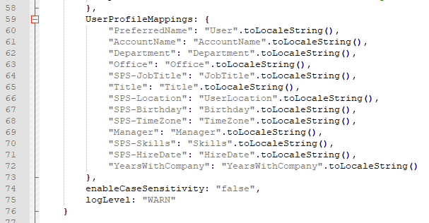

User Profile Mappings
  1. Go to the DefaultModuleSettings.js file and scroll down to UserProfileMappings, shown in the following graphic:

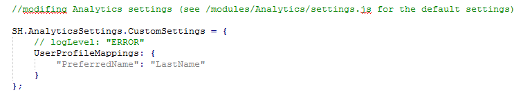

  2. Modify the names of the User Profile Properties with your properties.
    1. For example, PreferredName can be modified in LastName.
  3. Copy the UserProfileMappings parameter and values into your custom page settings file, such as CustomResultsSettings.js for the Results.html page.
