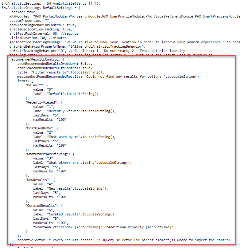

  8. Search for the word "recommendedResultsControl" on the page to quickly navigate to the Recommended Results default settings, nested under the AnalyticsSettings component shown below:

  10. Copy the entire recommendedResultsControl section.

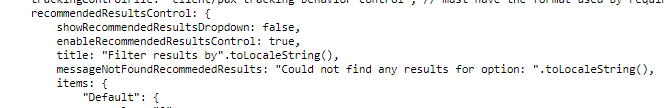

  2. The Recommended Results items are stored 5 lines under the recommendedResultsControl: { line in the settings file:
  1. Copy the settings nested under the items: { line.
