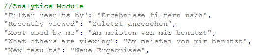

How to Create a Dictionary
  1. Go to the directory <SmartHub_install_dir>/js/cultures/.
  2. Make a copy of file en.smarthub.js.
  3. Change the first two letters (en) with you language.
    For example, de.smarthub.js.
  4. Open your new file and translate every label from the file.
  5. Save the file in the directory <SmartHub_install_dir>/js/cultures/.
Example:
