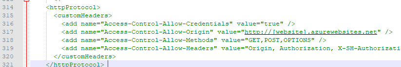

Enable CORS
- Navigate to your SmartHub installation root directory.
- Open the file web.config for editing.
- Enable CORS by uncommenting the section for cross-domain requests, around line 312, currently.
- Change the value of the parameter
Access-Control-Allow-Original, currently around line 314 to the value of your WordPress instance.- For example, https://myWordPressinstance.com
- Remove the X-Frame-Options and Content-Security-Policy headers.
