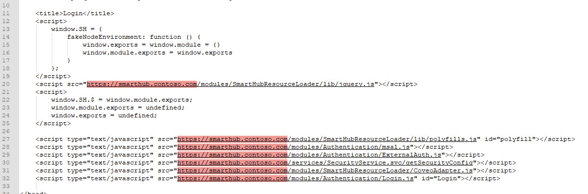

- Update the src attribute for all the script tags: prefix the path with the full address to your SmartHub site (https://yoursite.com) as shown in the example below, (which uses the sample site https://smarthub.contoso.com):

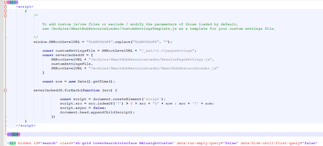

- Edit the file SPOEmbed-Results.html and make the following changes:
- Remove all the non-script tags from the head and everything above the <head> tag.
- Replace the
<head></head>and<body></body>tags with<div>and</div>while keeping the inner contents of those tags:
- For the DIV with ID "search" add a new attribute data-main="true"
- Replace the src attribute of logo with absolute URL.

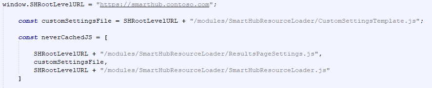

- Change the
SHRootLevelURLvalue to your SmartHub root address, as shown below:

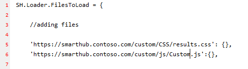

In the UI Editor, open and edit the page settings file that is used by the custom results page.
- Change the URL to any custom CSS or JavaScript file that was added to it to use the full SmartHub URL instead of the relative URL (or to use the
SHRootLevelURLas shown below):

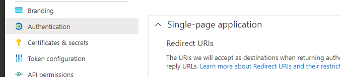

Navigate to the Azure Portal App registration used by SmartHub authentication.
Edit the list of Single-page applications (under Authentication).
Add the URL to the Login.aspx page you uploaded to SharePoint, such as https://customer.sharepoint.com/SitePages/Login.aspx
