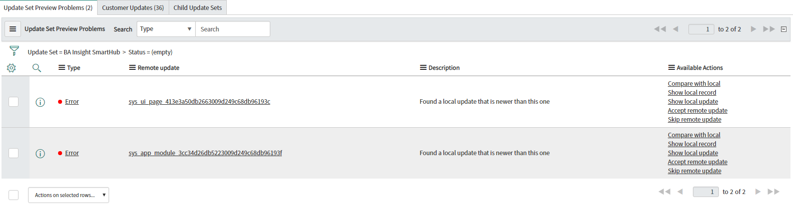

Once the Hub is installed, it can be quickly updated with a new xml file by following the same installation steps with one minor difference:
  • After previewing the new file, the user will be prompted to several errors informing him that identical files have been found in ServiceNow.
  • After agreeing to replace all respective files by clicking the Accept remote update button, the user can commit the update set.

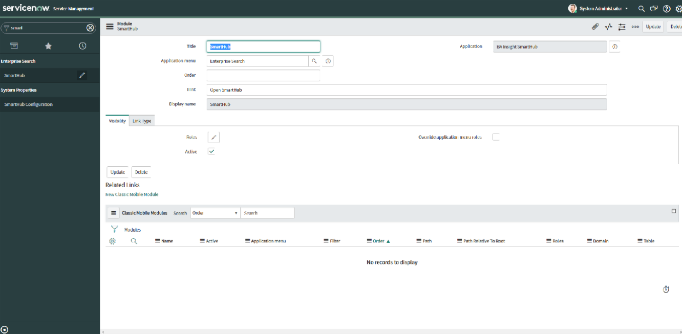

How to Modify the Hub
Once the Hub is installed, the user has the option to modify several parts of it through the ServiceNow interface:
  1. Go to your ServiceNow instance:
    1. Go to the Module page (System Definition > Modules)
    2. Search for the SmartHub module to open and edit it.
  2. Switch between the available SmartHub tabs to edit and update any information that you require through the Edit Module button.
    • Names
    • Descriptions
    • Titles
    • Hints
It is important to note that modifications revert back to their defaults whenever the app is updated.
