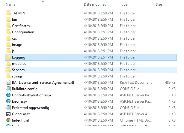

How to Access the Log Files
The log files are located in the logging folder of the SmartHub directory.
See the following graphic.

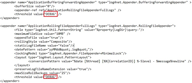

How to Change the Log Level
- Use a text editor to modify the FederatorLogger.config file in your SmartHub folder.
- Change all of the threshold values from
WARNto one of the following levels:
- INFO
- ERROR
- DEBUG
