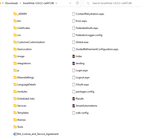

Extract SmartHub Files to a Local Directory
  1. In Windows Explorer navigate to the location where you downloaded the SmartHub installation package.
  2. Extract the archive to a directory of your choice, such as C:\Program Files\BA Insight\SmartHub\.

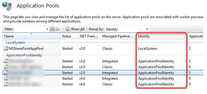

Give Read/Write Permissions to System User Running Application Pool
To give permissions only to the system user running the application pool, assuming you are using IIS, perform the following steps:
  1. Open IIS.
  2. Select the Website for which you need to modify permissions.
  3. Go to Basic Settings and identify which application pool account you are using.
    1. For example, "SmartHub".
    2. By default you see ApplicationPoolIdentity.
    3. Note that most administrators change this identity to a different user account, such as <domain>\<YourSmartHubUser>.
  4. Go to Application pools and find the application pool from the previous step.
  5. Find the system account used for running this application pool (Identity column).

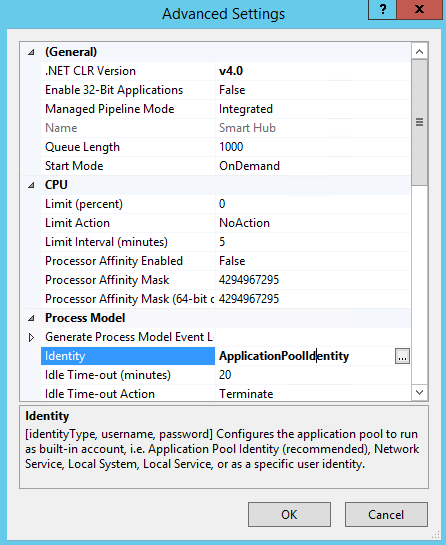

    4. Next, configure the SmartHub Application Pool as follows:
    • Set start mode to “Always Running”
    • Set Idle Time-Out (minutes) to 0
    • Disable application pool recycling

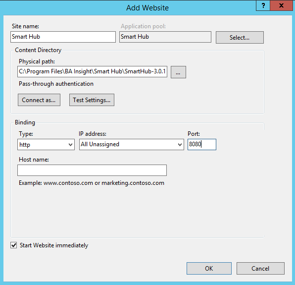

Create the SmartHub Web Site in IIS
When using the default settings below, the App poolaccount that is created does not have "Modify" permissions on the configuration folder and therefore cannot read or write configuration settings.
To secure the configuration folder for the App pool account (if the application pool account is the "auto-generated" one), see "Give Read/Write Permissions to System User running Application Pool" above.
  1. Open IIS manager.
  2. Expand <Sites>.
    1. Right-click on <Sites> and select Add Website from the pop-up window that appears.
  3. Site name:
    1. Enter your site name. For example, enter SmartHub.
  4. Physical path
Bindings
Note: Once SmartHub is installed, depending on your chosen method of authentication (Ex. Windows authentication), you can enable either HTTP or HTTPS bindings.
As part of the installation process you create HTTP and HTTPS bindings.
  • Type:
    • http
    • https
Use the following steps to enable both bindings in your SmartHub site:
  1. The Site Creation Wizard in IIS allows only a single binding when first creating a site (either HTTP or HTTPS).
  2. After you create your SmartHub site, create a second, additional binding to the same site.
  3. Port

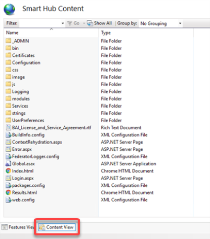

  4. If you select Content View from the bottom of your SmartHub Content site, your folder structure should resemble the structure shown below:
To access the site, users must have READ access to the folder.
How to Change Your Application Pool Identity Account
The SmartHub Application Pool Identity account must Local Administrator account with the following permissions:
  1. Run a Windows Scheduled Task (required for the BAInsight Analytics Sync Tool).
  2. Manage the Windows Service Bus (required for the BAInsight Analytics). To check if the user has permission follow the next steps:
    1. Open a Service Bus PowerShell as administrator.
    2. Check to see if you have created a service namespace by issuing the following PowerShell command:
      Get-SBNamespace
    3. Verify if the ManageUsers group include your account.
    4. Add permissions to your account using the following PowerShell command:
