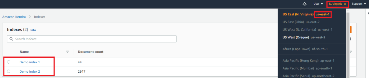

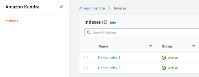

    5. Index name: The name of the AWS Kendra index to be used at search time. This name is located in the Kendra management page.
    6. Endpoint: the URL that is the entry point for the web service.

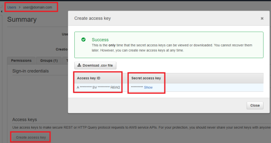

    7. Access Key: The IAM Access Key to be used at search time for authorization.
    8. Secret Key: The IAM Secret Key to be used at search time for authorization (see screenshot above).
    9. Region: The Region where the AWS Kendra instance is hosted. You can find this in the Kendra management page.
