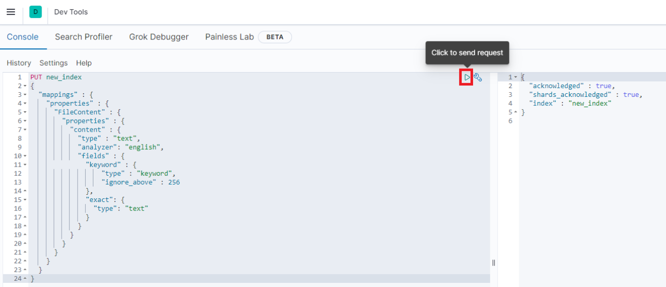

Click on the Dev tools to open the console.
Create a new Elasticsearch index by using the following code snippet, with the following adjustments:
- Replace new_index_name with the desired name for the Elasticsearch index.
- Specify the field(s) which should use a different analyzer.
- In the code snippet below, the content property of the FileContent property will use a custom analyzer.
Replace your_analyzer_name with a build-in analyzer (for example the language analyzer english) or a custom analyzer.
Add the exact field if you want to have exact matches on that property.
PUT new_index_name
"mappings" : {
"properties" : {
"FileContent" : {
"properties" : {
"content" : {
"type" : "text",
"analyzer": "your_analyzer_name",
"fields" : {
"keyword" : {
"type" : "keyword",
"ignore_above" : 256
"exact": {
"type": "text" }
- Run the command.
