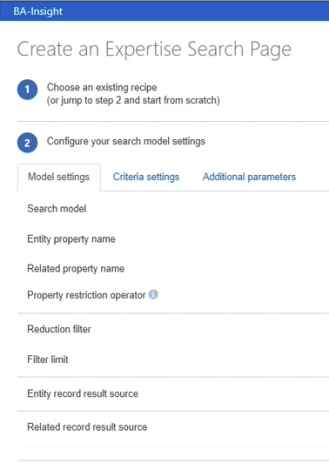

Model Settings tab
Search Model
For a general purpose Expertise setup, BA Insight recommends using: Entities based on related and Entity Search.

- Entity property name
- Property in the entity query linked to related records
- Example: People
- Related property name
- Property that links related records to the entity query
- Examples: author, docAuthorAccount
- Property restriction operator
- The operator used when creating property restrictions
- Reduction filter: The mechanism that selects relevant related records
- Facet reduction:
- A filter reduction. Counts related records to rank search results.
- For example, a search for "California labor law," if user Joe has 300 records and user Sally has 50 records, Joe is recommended as the expert.
- Metadata reduction
- Related record relevance is used when calculating ranks
- Customer Filter
- Custom filter name: Specify a custom filter name from the registered search engine filters
- Row limit: The max number of related records to be considered
- Facet reduction:
- Filter Limit
- The max number of values extracted from related facet.
Note: A large Filter limit can cause performance issues

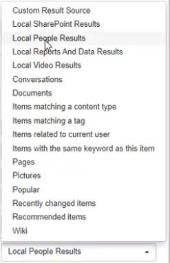

- Entity record result source
- The result source to pick entity records from
- Related record result source
- The result source to pick related records from

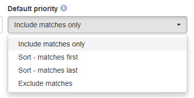

- Default property: Select the default priority for criterion
