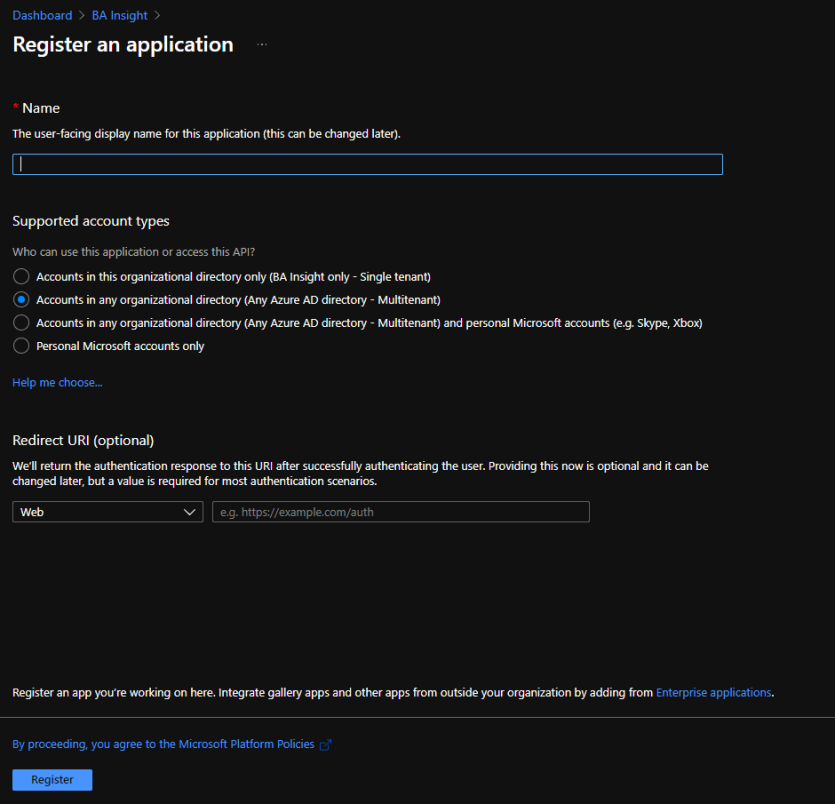

  1. Navigate to portal.azure.com and log in.
  2. From the left side menu go to Azure Active Directory → App registrations → New registration
    • Name: Enter the name of the application.
    • Application type: Select Web app / API.
    • Sign-on URL: Enter the SmartHub's URL.
