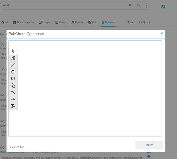

PubChem Settings
If you are setting up PubChem you must also add code to your HTML page's custom settings file, (such as a custom Results page).
The fastest and easiest way to do this is using the UI Editor.

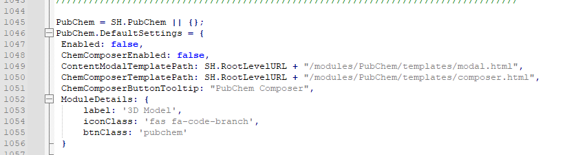

Scroll down to the PubChem custom settings section around line 225:
Click the link See Default Settings in the top right corner. A new browser tab opens with the available custom settings.
Scroll down or search for "PubChem," around line 1045. Enable PubChem and the ChemComposer:
- Add all PubChem code from and including line 1047 to your custom settings file open in the previous tab.
- Change the following settings from "
false" to "true":- Enabled
- ChemComposerEnabled
- Enable the PubChem Viewer.

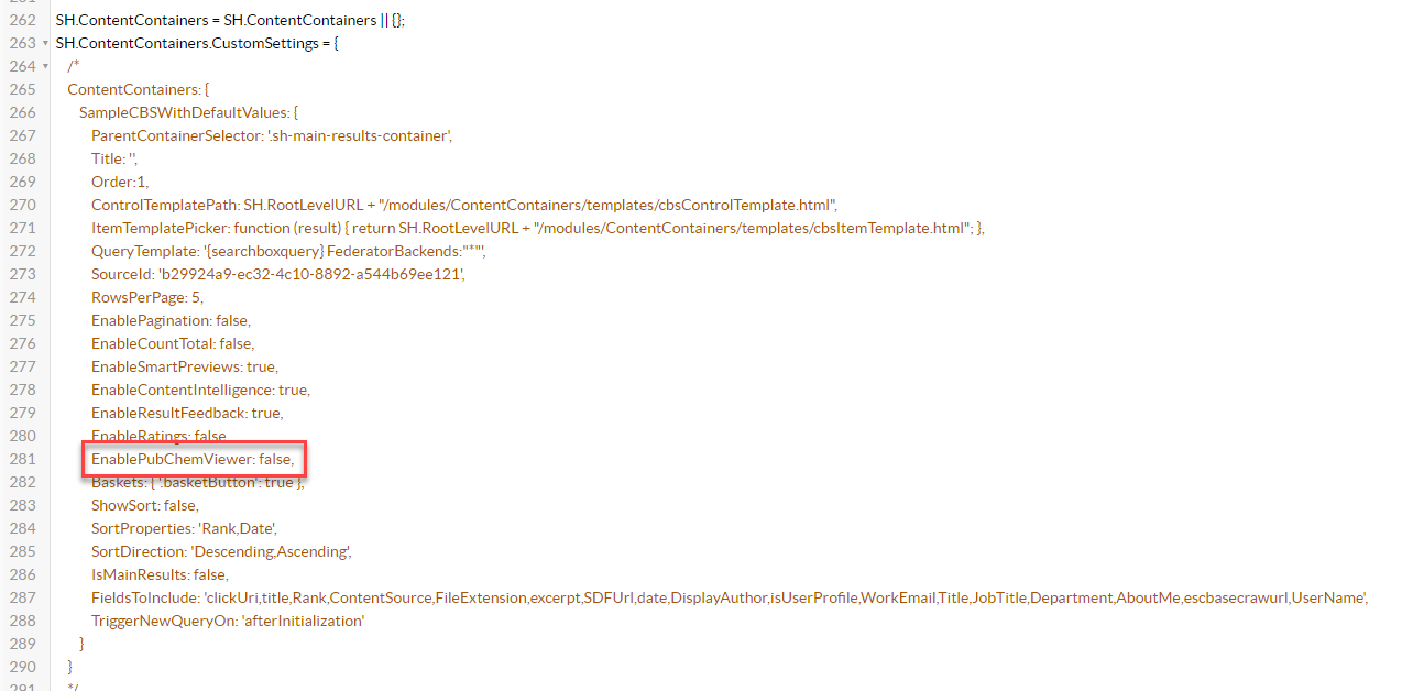

Scroll or navigate to the
ContentContainerssection in your custom settings file.Comment in the ContentContainers settings shown below, if necessary.
Change the EnablePubChemViewer value from
falsetotrue. See below.
Click Save changes.

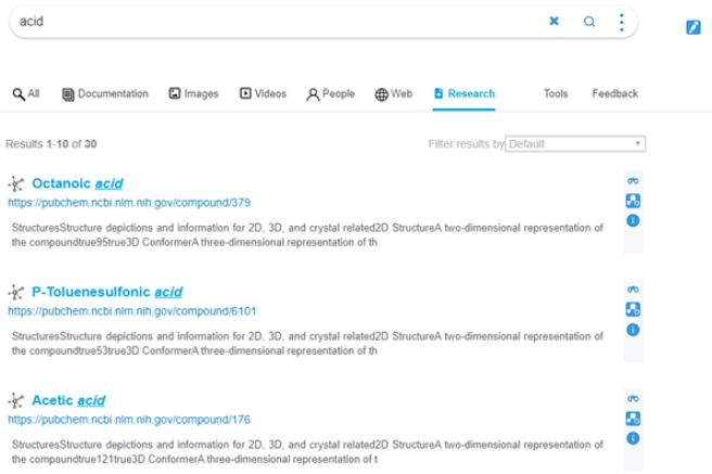

Results Page Example
Once configured, your site Results page will resemble the screenshot below:
