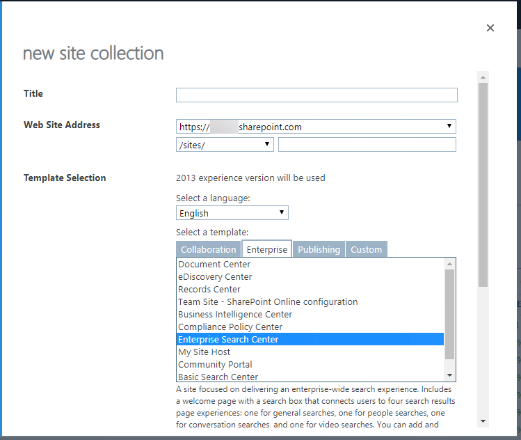

- Site url: Enter the URL for your SharePoint Online Search Center, which is a site collection created with a SharePoint "Enterprise Search Center" template. You may receive an error when performing a query if you do not use a Search Center URL in this field.
