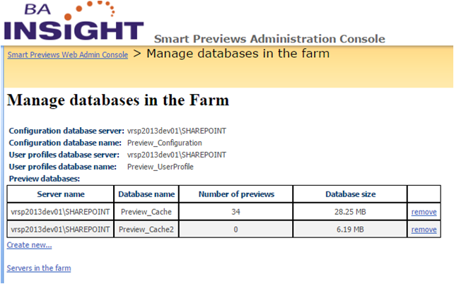

During the installation, three Preview databases are created that are used during the Preview generation process.
You can see information about these databases, and manage these databases using the Manage databases in the farm page.

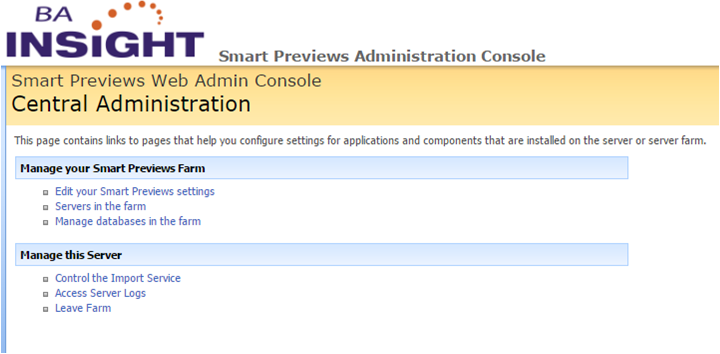

- On the machine hosting the Smart Previews Index Server, go to the Web Administration Console.
- The Smart Previews Web Administration Console - Central Administration page appears:
- Manage your Smart Previews Farm > Manage databases in the Farm.
- The Manage databases in the Farm page appears. See the information provided:
- Configuration database server: See the SQL server hosting the databases.

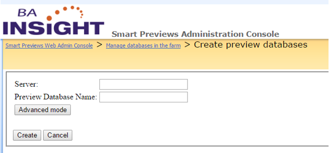

- Create new...: Click and the Create preview databases page appears.
- Server:
- Enter the SQL server name and the name of the instance (if an instance is used).
- Preview Database Name:
- Enter your preview database name.
- Advanced mode
- Optional
- Click Advanced mode to specify more parameters, such as specifying an authentication mode.
- This mode lets you use a connection string containing parameters that are unique to your organization:
- For a list of supported strings, see The Connection Strings Reference.
- Create: Click the Create button.
