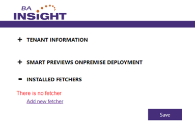

  1. Navigate to the Configuration page for the Smart Previews Hybrid site.
    1. For example: https://<SmartPreviewsHybridAddress>/Pages/Configure.aspx.
  2. Expand the INSTALLED FETCHERS section and click the link Add new fetcher.

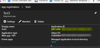

      • Application ID:
        • Enter the Azure Application ID
        • You can find the Azure Application ID when you access your Azure App in the registered applications from the Azure Portal:
        Note: Follow the steps from the section Configure Certificate Authentication to get the Certificate Distinguished Name and Application ID.

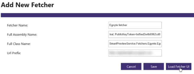

Egnyte Fetcher
Note: The Egnyte fetcher requires the Egnyte backend is installed in SmartHub.
Complete the fields listed below after clicking the "Add new fetcher" button.
  1. Fetcher Name:
    1. Name as desired.
    2. For example: "Egnyte Fetcher"
  2. Full Assembly Name:
    1. BAInsight.SmartPreviewHybrid.OnPrem, Version=1.0.0.0, Culture=neutral, PublicKeyToken=bd5ed2e4b6962cd0
  3. Full Class Name:
    1. SmartPreviewService.Fetchers.Egynte.EgnyteFetcher
  4. URL Prefix:
    1. https://<appYourDomain>.egnyte.com
  5. Load Fetcher UI:
    1. Click "Load Fetcher UI" to load additional fields.
  6. Egnyte Domain:
    1. Enter your Egnyte app domain.
    2. For example: appYourDomain.egnyte.com.

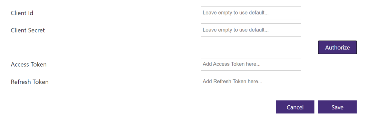

  7. Client Id:
    1. Enter your Egnyte client ID
  8. Client Secret:
    1. Enter your Egnyte client secret
  9. Click the Authorize button.
  10. A new tab opens. Follow the prompts to login to your Egnyte account.
  11. Click Allow Access.
  12. A web pages opens entitled "404 File Not Found." This is expected.
  13. Copy the code from the URL location bar at the top of your browser, from after the '=' character to the '&' character. See the graphic below.
  14. Return to the Edit Fetcher page (in a previous browser tab).
  15. Paste the copied code into the "Authorization Code" field.
  16. Click the Get Tokens button.
  17. A new web page opens with a generated Access token. No Refresh token is required.
  18. Copy the Access token.
  19. Return to the Edit Fetcher page (in a previous browser tab).
  20. Paste the Access token into the Access Token field.
  21. Click Save.

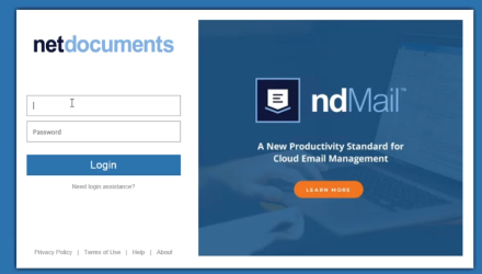

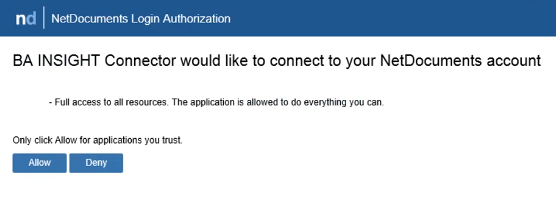

  6. Click the Authorize button.
  7. This opens the NetDocuments web page.
  8. Login using your NetDocuments credentials.
  9. Click Allow on the page that appears next.
  10. Copy the code that appears.
  11. Return to the Edit Fetcher page and paste the code into the Authorization Code field.

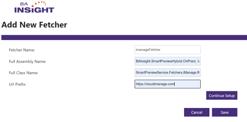

iManage Fetcher
  1. Fetcher Name:
    1. Name as desired.
    2. For example: iManage Fetcher
    • BAInsight.SmartPreviewHybrid.OnPrem, Version=1.0.0.0, Culture=neutral, PublicKeyToken=bd5ed2e4b6962cd0
  3. Full Class Name:
    • SmartPreviewService.Fetchers.iManage.IManageFetcher.
  4. URL Prefix:
    Enter either:
    • https://cloudimanage.com
    • or the address that iManage DataCenter enforces
  5. Load Fetcher UI:
    1. Click "Continue Setup" to load additional fields.

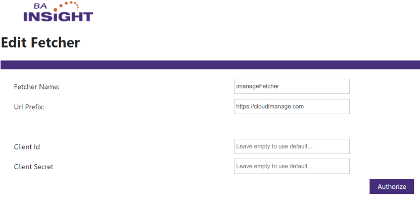

  6. Fill in the Client Id/Secret fields.
    • Leave empty to use the default values.
  7. Click Authorize
  8. Login to iManage.
  9. A web page appears showing an Access token and Refresh token
  10. Copy the tokens separately.
  11. Return to the "Edit Fetcher" page.
  12. Paste the tokens into their respective fields.
  13. Click the Save button.
  14. Navigate back to the Configuration page for the Smart Previews Hybrid site.
    • For example: https://<SmartPreviewsHybridAddress>/Pages/Configure.aspx.
  15. Refresh the page. Your new iManage fetcher appears.
