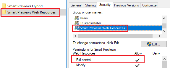

    Service Account
    Your Smart Previews Service account requires full control security permissions to the Web Resources folder.

Verify Application Pool Permissions on the Installation Folder
The following instructions verify the Identity and permissions of the Application Pool configured above.
  1. In IIS, select the Application Pools as shown in the graphic below.
  2. The user shown in the Identity column must have READ/WRITE permissions to the Smart Previews Web Resources folder created in step 1.
  3. If you use the default ApplicationPoolIdentity user, you must grant READ/WRITE permissions to the auto-generated IIS user named "IIS APPPOOL\Smart Previews Web Resources"

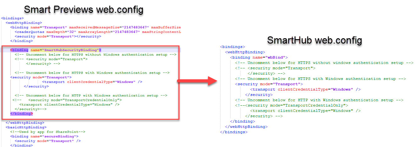

  3. You must configure the Smart Previews Web Resources site to reference the SmartHub URL that is accessible from the server where the Smart Previews Web Resources are being installed.
    SmartPreviews Web Resources relies on SmartHub for authentication.
    1. Open the Web.config file if it is not already open.
    2. Locate the appsettings\SmartHubAddress section, around line 76.
      1. Change the address to match your SmartHub URL using this format: https://<smarthubsite>.com.
      2. For example: https://MyCompany.mydomain.com
    3. Locate the appsettings\SetupModesection, around line 75. Change the value to "SmartHub."
    4. Locate the system.serviceModel\bindings\webHttpBinding section, around line 114.
    5. Change the SmartHubSecurityBinding section to match the security section in your SmartHub web.config file, which is located at the root level of your SmartHub installation directory.
      1. This requires commenting or uncommenting code in the section, as necessary.
      2. In the example below, the security binding in both files is set to "HTTPS with Windows authentication setup."
