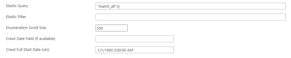

Crawl all indexed data

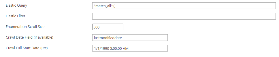

Crawl all indexed data where lastmodifieddate property is greater than the specified data

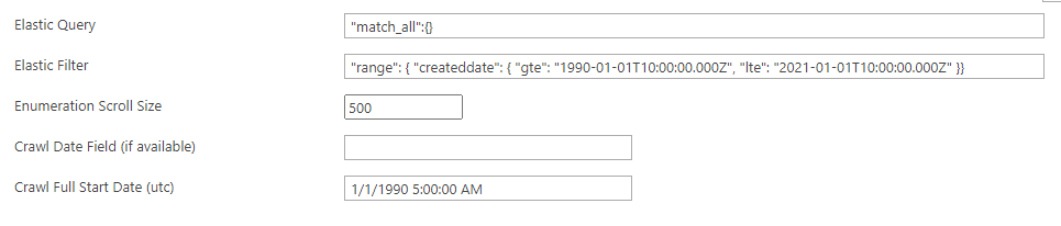

Crawl all indexed data where createddate property is between to dates

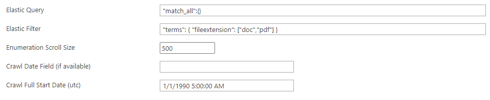

Crawl all indexed data where fileextension property contains "doc" or "pdf"

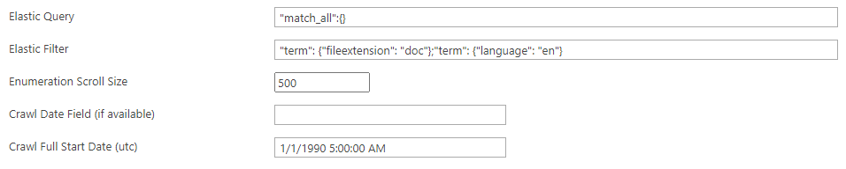

Crawl all indexed data where fileextension property contains "doc" and the language property equals "en"
