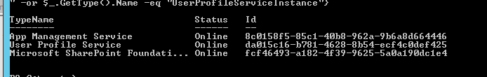

To determine if the SharePoint Farm is ready, look under Application Management to determine if each service is installed and running. Alternatively, run the following PowerShell command as a SharePoint Administrator:
Get-SPServiceInstance | where{$_.GetType().Name -eq "AppManagementServiceInstance" -or $_.GetType().Name -eq "SPSubscriptionSettingsServiceInstance" -or $_.GetType().Name -eq "UserProfileServiceInstance"}
