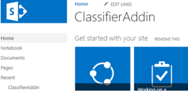

  1. Go to the site collection where you installed the SharePoint ClassifierAddIn:
    See the ClassifierAddin page.
