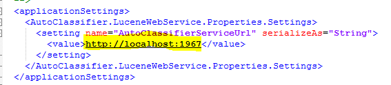

Lucene Component
Lucene is included by default with the AutoClassifier Engine.
  • If the Lucene component is not installed separately, skip this step.
  • In scaled environments, the Lucene component can be installed separately.
Procedure:
  1. Open IIS on the server hosting AutoClassifier.
  2. Locate the Lucene Component site.
  3. Locate and open the web.config file for editing.
  4. Update the AutoClassifierServiceUrl address to the new HTTPS address
