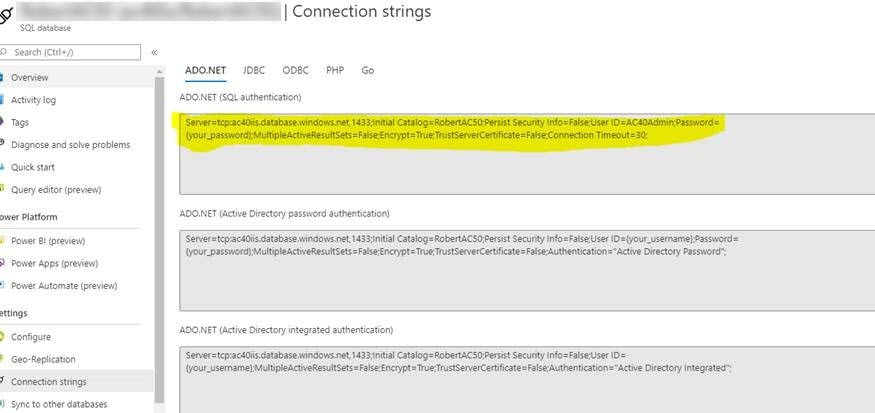

  1. In the Initialize Database and Configuration screen, enter your SQL Database string in the Database Settings field. For more information, see Azure SQL Database Connection String Examples below.
  2. This string can be taken from Azure itself under Settings > Connection strings. Do not copy and paste the connection string.
  3. Azure SQL strings require special attention: The string provided by Azure in the field ADO.NET (SQL authentication) shown below does not contain the password. See the code string at the bottom of this page.
  4. There are two solutions to this:
    1. Enter Your SQL Password in the "Database Settings" Page:
      • Remove the password field from the connection string and put the password in the "Password" text box in the AutoClassifier Database Settings page
    2. Modify the Connection String:
      • Enter the password in the connection string and it will be processed with the rest of the SQL database script at run-time.
