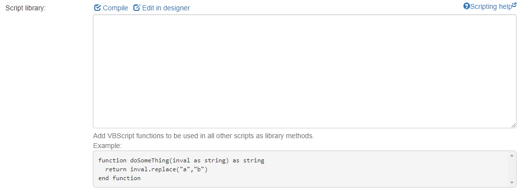

To access and use the Script Library, follow these steps:
  1. Go to Content > Content > <content source name> and click the Advanced tab.
  2. Script Library:
    1. Scroll down to and write your custom function, which uses any standard. VB.NET function, here.
    2. The output of the script is determined by your final return statement.
    3. This output can be in the form of integers, DateTime, string, string array, or any other VB.NET type.
  3. Compile:
    1. Click to validate your function.
    2. Perform this operation for each function that you add.
  4. Save: Click to add this function to the library.
