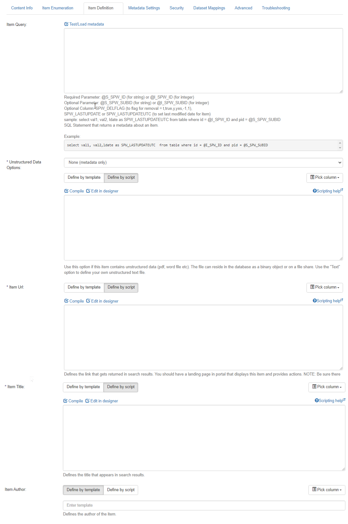

  1. In The Framework Admin Console select the Content tab.
  2. On the Content Management page select for your SQL Content Source.
  3. Click the Item Definition tab.
  4. Item Query:
    1. Enter a SQL statement that returns metadata about an item based on the unique identifiers returned in the enumerator.
    2. You can enter more than one SQL statement here, separated by a semi-colon, as long as the first statement returns only one row.
    3. The data in subsequent statements can be accessed directly through the scripting interface on any of the metadata fields.
    4. After entering your SQL, you can click the Test and Load Metadata link above the entry box to validate your query and pre-load the Select column quick-pick boxes

  6. Item Url:
    1. Use to define the link that gets returned in search results.
      Note: Verify there is a crawl rule allowing this host, or it will not be indexed.
    2. Click Crawl Rules to manage the crawl rules.
  7. Item Title:
    1. Define the title that appears in search results.
  8. Item Author:
    1. Define the author of the item that appears in search results.
    2. See Standard Format Field.
  9. Click Save.
