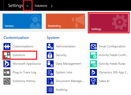

- Navigate to your Dynamics → Settings → Solutions page.

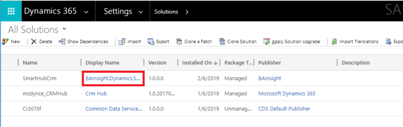

- Click on SmartHubCrm's display name to open the SmartHub configuration page, shown here:

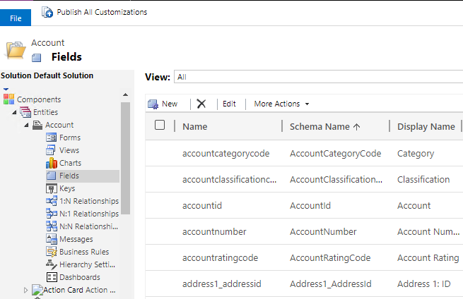

How to See All Configurable Entities
- Navigate to Dynamics → Settings → Customize the System.
- On the left side menu, under Components, expand the Entities.
- Expand the desired entity, click on Fields to see all properties for an entity.

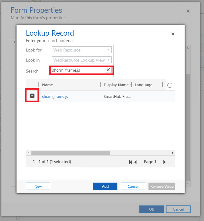

- On the Form Properties → Form Libraries add the shcrm_frame.js.

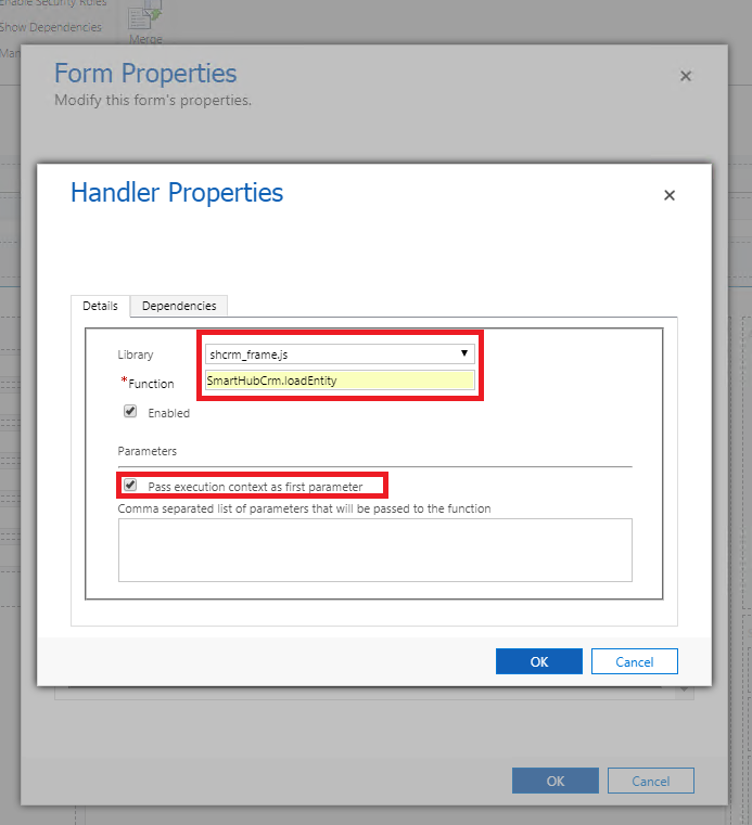

- On the Form Properties → Event Handlers add as a Form control and OnLoad event the SmartHubCrm.loadEntity function from shcrm_frame.js library and check Pass execution context as first parameter.

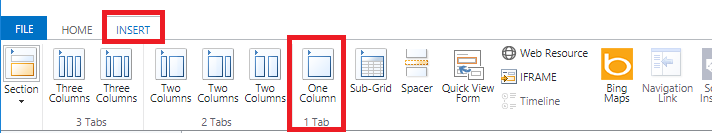

- Insert a new One Column Tab on the page.

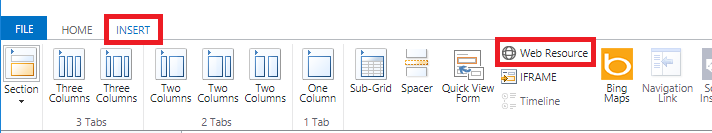

- In the new Tab created insert the shcrm_frame.html as a Web Resource.

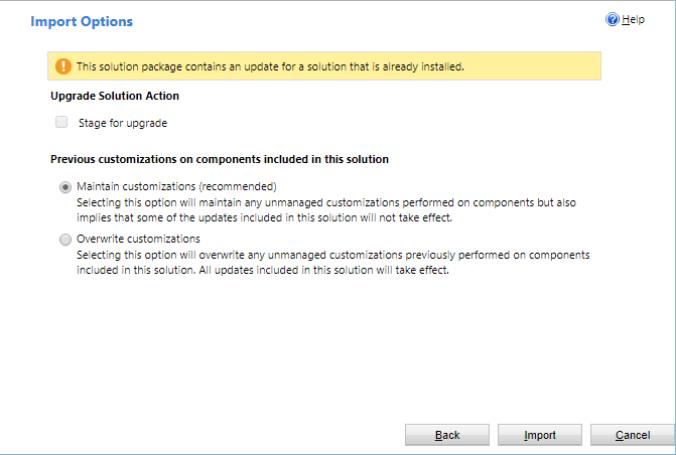

- Click on Import and select the new zip archive with the solution to upload.
* Be sure to check Maintain customizations in case you customized the Hub before.
