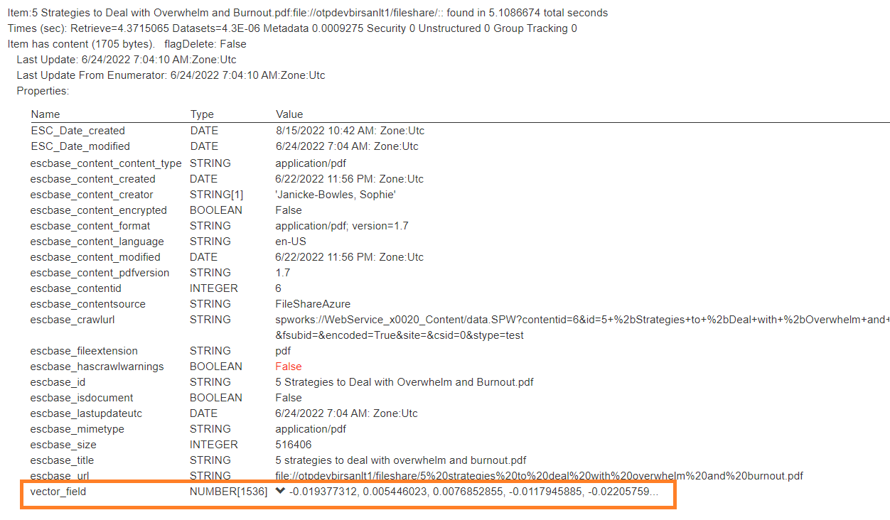

  • Run a TestBench and validate that your vector field contains an array of float numbers. Verify that the dimension of the array matches the dimension of the vector field that you specified in step 9b above.

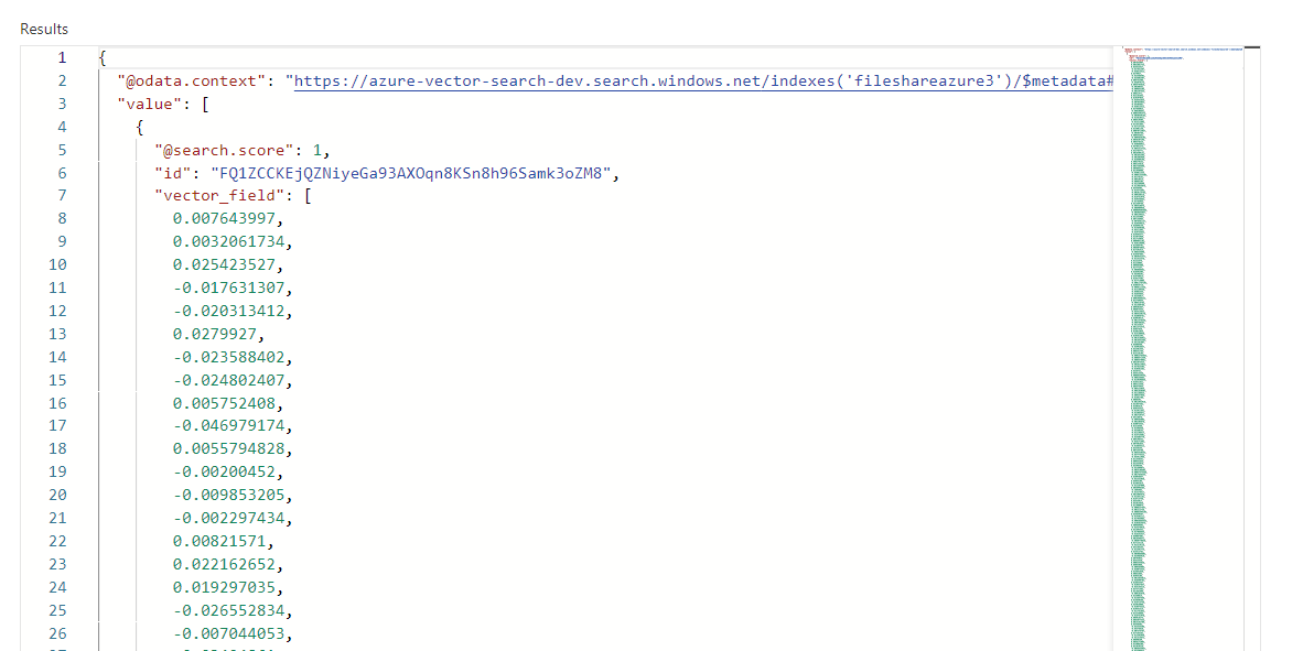

  • In the Microsoft Azure portal, select your index and verify that the vector field is populated in the index and that the name of your vector field is include in the Fields tab.

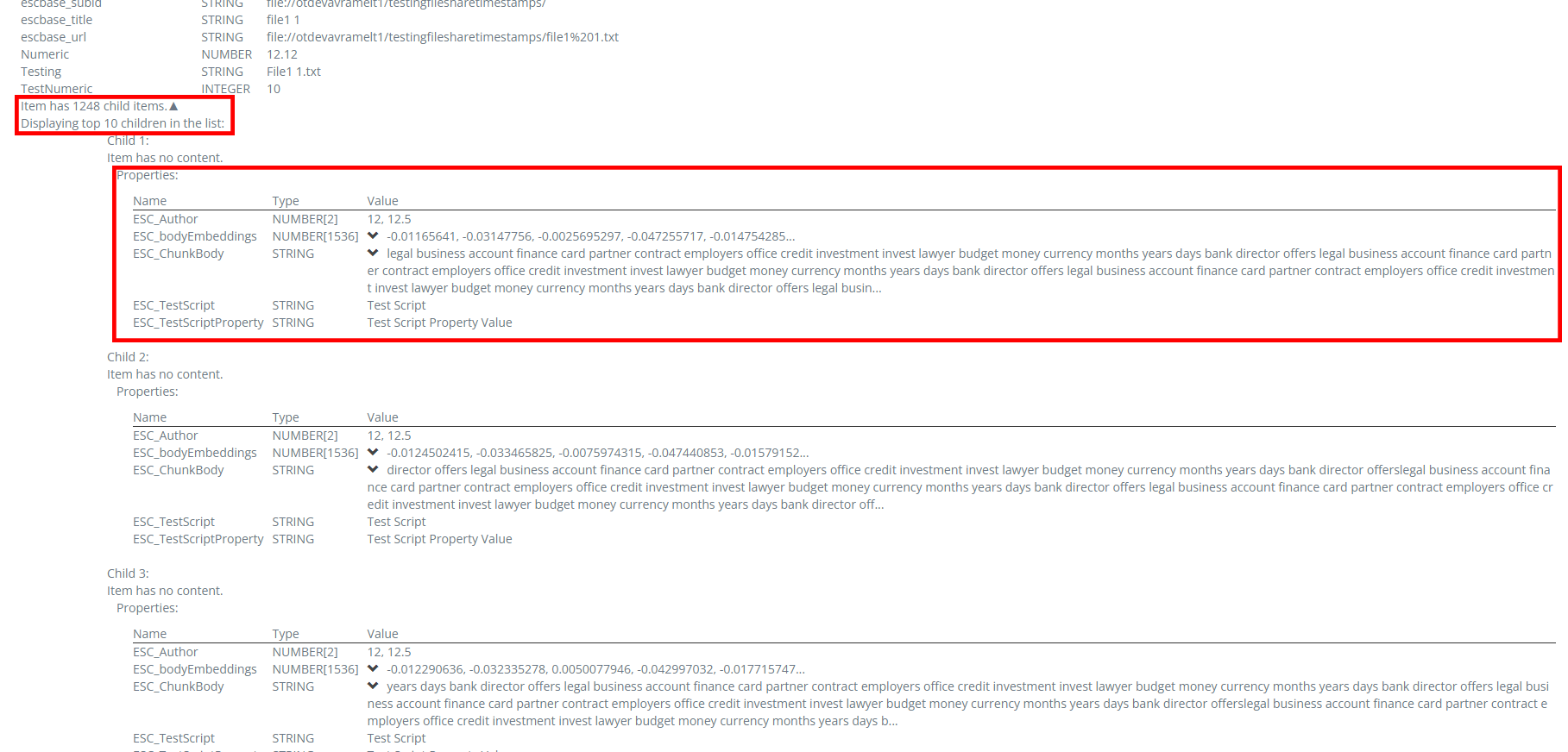

  • Run a TestBench on the content source and validate that you can see the number of child items. This appears as in the Name column with the text "Item has x child items.". You can click on this text to expand each child item to view the property that you specified in the PropertyName field when you configured your enrichment pipeline and any additional properties that you specified in a script (see Alter chunks with a script component). TestBench will show the top 10 child items if more than 10 child items exist.

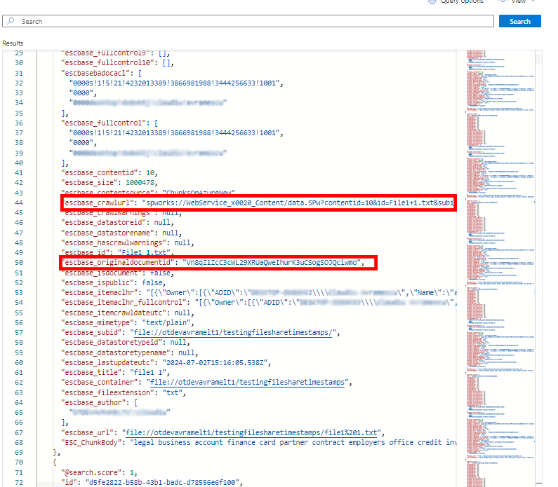

  • In the Microsoft Azure portal, verify that the properties that you specified in the PropertyName field when you configured your enrichment pipeline are present. Additionally, you can verify that the following properties maintain information about the parent document:
    • escbase_crawlurl: This is the url to the parent document.
    • escbase_originaldocumentid: This is the document id of the parent document.
