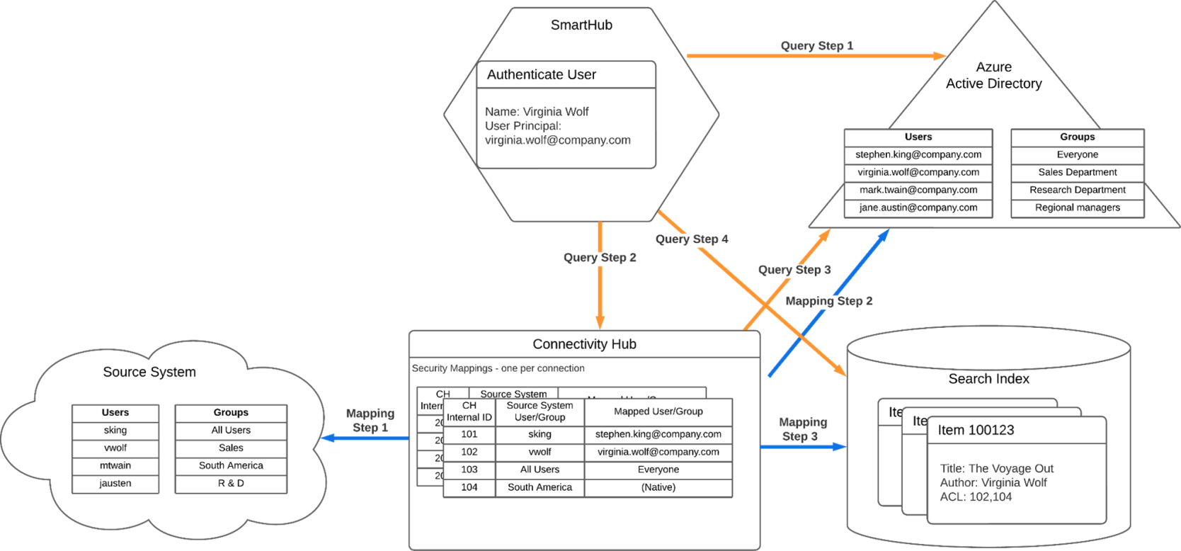

The below image depicts the various components used in security trimming and identifies two different flows:
SmartHub and Connectivity Hub flows

Workflows
See the image above, SmartHub and Connectivity Hub flows.
  • The two workflows:
    • Mapping flow
    • Query flow
Mapping flow (index-time)
The “Mapping” flow (marked with blue arrows in the image above) is handled by Connectivity Hub during indexing:
  • Crawls source content and reads associated permissions.
  • Matches source users/groups to the directory identity system (e.g., Azure AD).
  • Writes indexed items with ACLs reflecting normalized user/group IDs.
Query flow marked by orange arrows
The “Query” flow (marked by orange arrows in the image above) is handled by SmartHub when a user issues a search: SmartHub
  • SmartHub authenticates the user against the identity provider.
  • SmartHub retrieves the user’s group memberships via Connectivity Hub.
  • SmartHub issues the search query to the index including the user’s identity and groups.
  • Only items whose ACLs permit the user (or their groups) are returned.
Flows
Mapping Flow
Query Flow
Step 1 During the security sync: the connector reads the users/groups from the source system. The user accessing SmartHub authenticates against the authentication provider
Step 2
During the security sync: Connectivity Hub matches the users and groups found in the source system with users/groups in the target directory.
For groups, if a match is not found in Active Directory, Connectivity Hub stores the members of that group (Members identified from the source system) in a “native” mapping.
At query time, the Advanced Security Module stage queries Connectivity Hub with the user’s info, to get that user’s group memberships.
Step 3 At crawl time: The security descriptors for the items being crawled are read, and the corresponding internal Connectivity Hub identifier is written into the ACL property for that item in the index. While retrieving the user’s group membership, Connectivity Hub calls the Target directory to find current directory group memberships.
Step 4
Finally, when sending the query to the search index, the query contains information to insure only items with an appropriate ACL list are returned:
  • Items available to this user, or any group this user is a member of.
