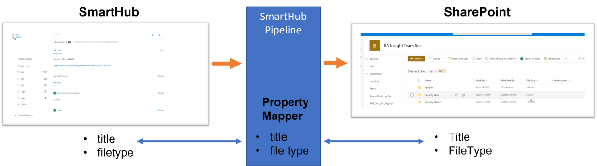

Example Tuning Stage: Property Mapper
In the example below, the SmartHub Property Mapper tuning stage maps two terms:
- "title"
- "file type"
This results in SmartHub users discovering consistent results when searching content across different content sources.
