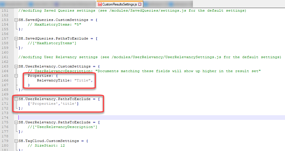

  2. Add the following code to your custom settings file, (around line 163 for Results settings and 149 for Index settings), as shown in the graphic:
    SH.UserRelevancy.CustomSettings = {
    Properties: {
    RelevancyTitle: "Title",
    SH.UserRelevancy.PathsToExclude = [
        ['Properties','title']
