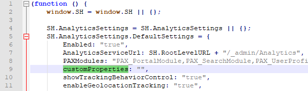

- Open DefaultModuleSettings.js, located at <SmartHub_install_dir>\modules\SmartHubResourceLoader\.
- Go to the file and scroll down to
customProperties, around line 9.
- Enter the name of your custom properties into
customProperties:"",. To enter more than one property, use a comma (,) delimited list. - Copy the
customPropertiesparameter and values into your custom page settings file (not shown in the screenshot below), such as CustomResultsSettings.js for the Results.html page.- For more information about custom files, see Filters.

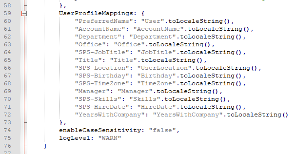

- Go to the DefaultModuleSettings.js file and scroll down to
UserProfileMappings, shown in the following graphic:
- Modify the names of the User Profile Properties with your properties.

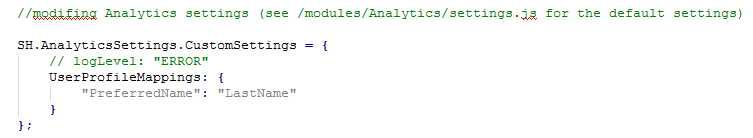

- For example,
PreferredNamecan be modified inLastName.
- For example,
- Copy the
UserProfileMappingsparameter and values into your custom page settings file, such as CustomResultsSettings.js for the Results.html page.- For more information about custom files, see Filters.
