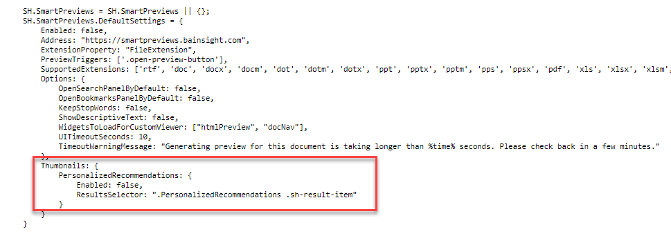

  9. Search for the word "Thumbnail" on the page to quickly navigate to the Document Thumbnail default settings, nested inside the SH.SmartPreviews section, shown below:
  10. Copy the Thumbnails settings section from SH.SmartPreviews.DefaultSettings.
    1. In the example above, this section is contained in lines 306 to 310.
  11. Go back to your Advanced settings edit tab.
  12. Paste the copied settings inside section SH.SmartPreviews.CustomSettings.
    1. Change the PersonalizedRecommendations section as follows:
      • Enabled: Set to true to display the documents thumbnails for the selected container.
      • ResultsSelector: The selector used to get the results list for which the documents thumbnails will appear.

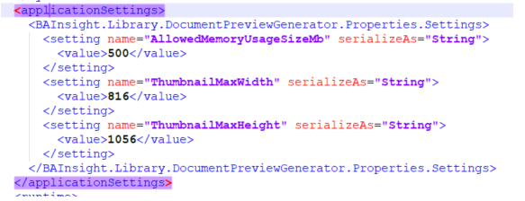

The thumbnails size can be modified as follows:
  1. Locate and open the configuration files found in the bin folder from the Smart Previews Import server (<SmartPreviewsForSmartHub_root>\SmartPreviewsFrontEnd\bin)
    1. Preview offline: PreviewGeneratorV5.exe.config
    2. Preview online (on-demand): AptivCachePreviewGenerator.exe.config
  2. Modify the values for the following settings (size in pixels):
    1. ThumbnailMaxWidth
    2. ThumbnailMaxHeight
  3. After modifying the configuration files, restart Smart Previews services for the changes to take effect.
