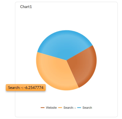

  • The ChartView component is used to display SmartHub results as a chart.
  • See the image below.

ChartView Settings Example
  • Use the ChartView code below, which contains two charts, "Chart1" and "Chart2," as an example.
