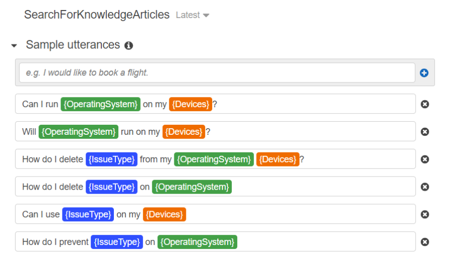

SearchForKnowledgeArticles Intent Example
- In the example below, the intent "SearchForKnowledgeArticles" is shown.
- Every line contains anutterance.
- Slots in each utterance are highlighted in different colors.
- Note that slots such asIssueType,OperatingSystem, andDevicesare a kind of keyword that can be recognized by your app.

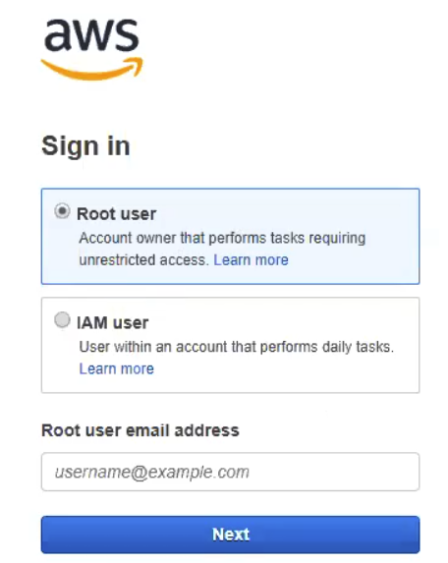

How to Create a Root/IAM User Account
In the following topics, you will use on of two available AWS user accounts:
- Root user:
- Account owner.
- Unrestricted access
- IAM user:
- Standard user.
- Restricted access.
- The App Key and App Secret (topics described below) are generated for each IAM user.
To create an account, go to aws.amazon.com and follow the instructions on the page.

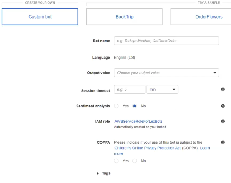

- Create a new (Custom) Bot. Under Bots, click Create > Custom bot.
- Fill in the Bot fields including "Bot name."
- Click the Create button.

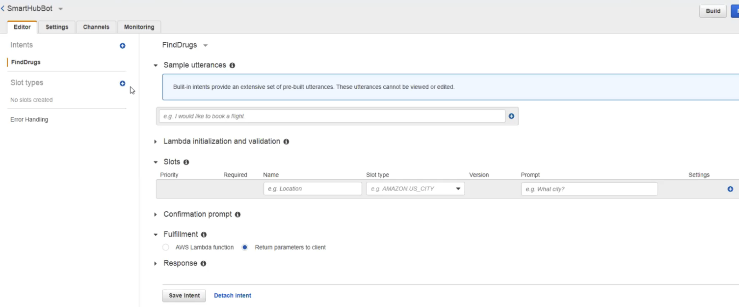

- To configure your bot with an intent, click the "+" icon next to Intents on the left side menu.
- In the example below, "FindDrugs" is the example intent.
- Next, configure your intent with utterances.
- Complete the remaining fields as desired.
- Click Save Intent.
- Enter as many intents as you desire.

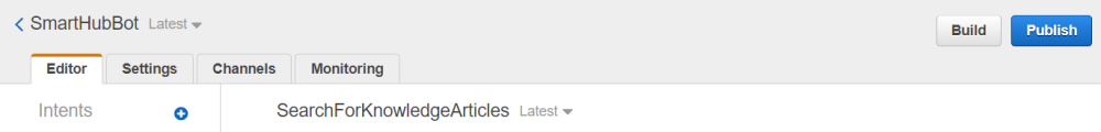

How to Build and Publish a Lex App
After you create and setup a Lex bot application, you next build and publish it.
- Select your bot.
- Select the Editor tab.
- Use the buttons in the upper right corner of the screen to build and then publish your Lex app.

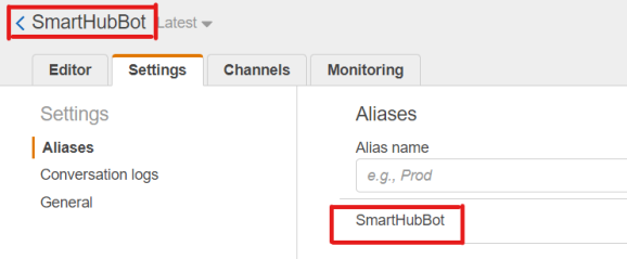

How to Get Your Bot Name and Bot Alias
For the Bot Name and Bot Alias fields:
- Go to http://console.aws.amazon.com and under Services search for Amazon Lex.
- Select an existing bot from the list or create a new one.
- Click Settings > Aliases.
- The Bot Name and Bot Alias are shown in the screenshot below:

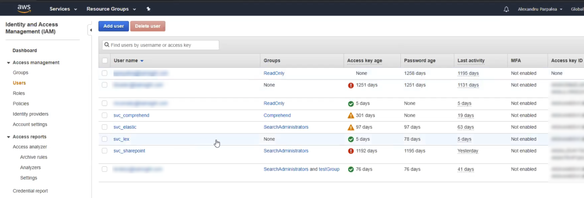

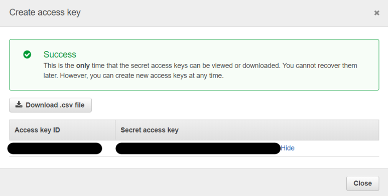

How to Create the App Key and App Secret
For get an App Key and App Secret you must have a user account with the AamzonLexFullAccess permission.
This cannot be created by the IAM user.
- Go to https://console.aws.amazon.com.
- Select Services from the top menu then search for the IAM service.
- Then, go to Users form the left panel and select an existing user or create a new one.
- Give the user the following permissions: AmazonLexFullAccess.
- Under the Security Credentials tab, click Create Access Key.
- A dialogue appears with the App Key and the App Secret:
