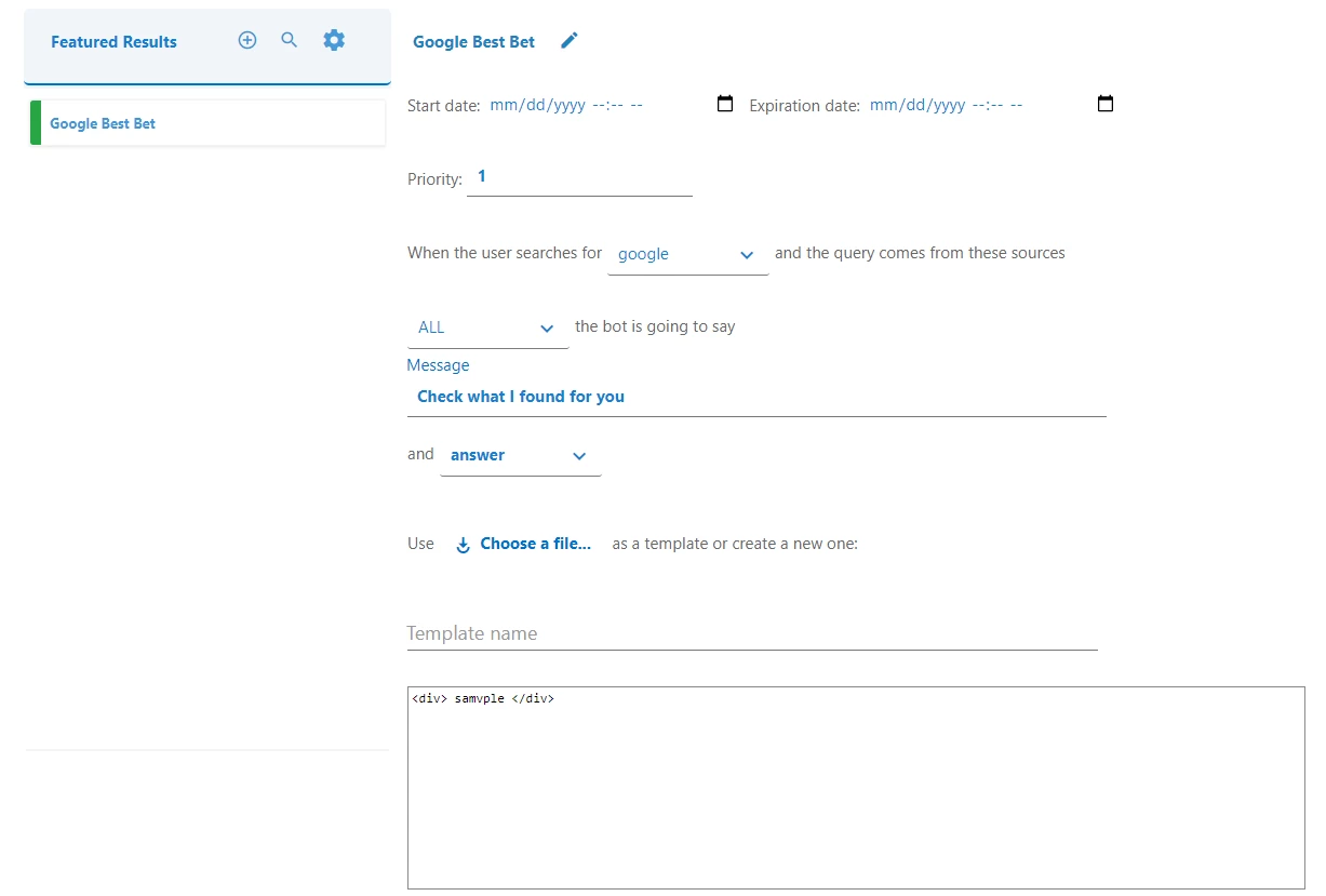

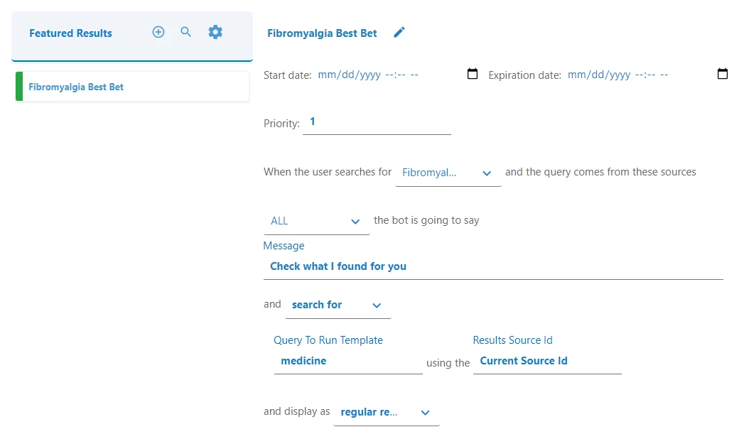

How to Configure Featured Results
Use the following instructions to configure a Featured Results.
- On the Questions And Answers page, click Conversation Topics.
- Select Featured Results.
- Click the "+" icon next to the "Featured Results" text at the top left of the screen.
- Start date: the date on which the featured result begins.
- Expiration date: the date the featured result expires.
- Name (at top of screen): Choose a relevant name for the Featured Result.
- Priority:
- Choose the priority of feature results in case that, there are multiple "Feature Results" with the same query term.
- Based on the priority configured, "Featured Results" is returned in search results.
- "When the user searches for"
- Add query terms here.
- There two types of query terms:
- Regular strings. For example: priority, case, version
- Regex strings Pattern for regex matching.
- For example: ([A-Z])\w+
- "query comes from these sources"
- Add results source IDs.
- This field will contain a list with results source IDs of the user's query
- "ALL" is the default value.
- It means that all results source IDs will be considered as valid.
- Choose the response method:
- "answer" - "HTML response": What the bot tells the user before the results are listed.
- "search for" - "Query To Run template":
- Generates the query made to SmartHub if a match is found for this item (hover over the icon to see which fields can be used inside the template).
- Choose a results source ID used to run the query and display results.
- The default value is "Current Source Id" which represents the result source id of the query made by user.
- Choose the template from the last field:
- Regular results
- Cards
- Carousel
- For cards or carousel display mode choose.
- n results - the top n results will be listed in SmartHub search page.
- Adaptive Cards JSON - The JSON template used to render the bot results.
Answer Display Mode
Regular Results Display Mode
Cards/carousel display mode

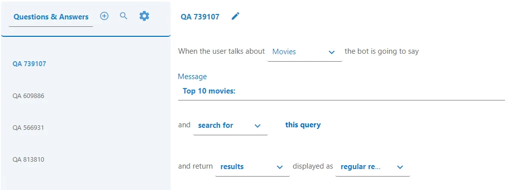

How to Configure NLQ Q&A
Use the following instructions to configure a Question and Answer.
- On the Questions And Answers page, click on Conversation Topics.
- Select NLQ Q&A.
- Click the "+" icon next to the "NLQ Q&A" label at the top left of the screen.
- Choose a relevant name for the NLQ Q&A.
- Choose the NLQ Service intents that matches this Q&A.
- This specifies what the bot tells the user before the results will be listed.
- "search for" - "Query To Run json object":
- Generates the query to be executed by SmartHub if a match is found for this item. You can click on this query to open the query builder panel.
- On the left side, you can see the most common properties that can be altered in the query. The JSON query on the right side will be updated based on your input.
- Choose whether you want to pick up specific metadata from your results or the entire results set.
- metadata: Choose which metadata field to extract from results
- regular results
- cards
- carousel
- To use a "cards" or "carousel" display mode choose:
- Display text: The text to be displayed on top of the card or carousel
- Adaptive Cards JSON: The JSON template used to render the bot results
Cards/carousel Display Mode
