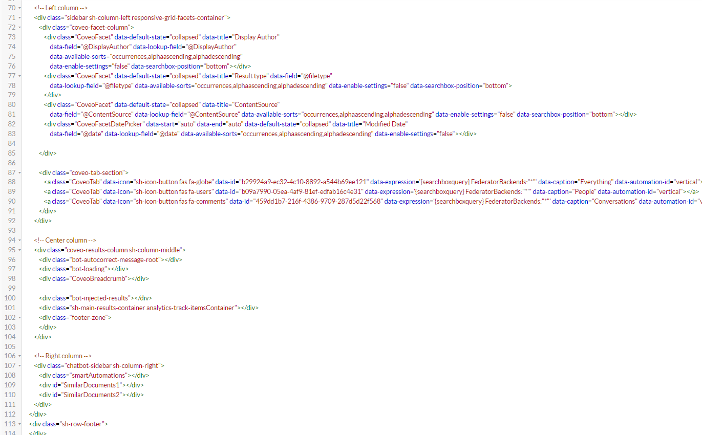

Left Column
  • Left column refiners are shown in the graphic below.
  • In your Results HTML file (or your custom Results HTML file), the left column refiners are defined around line 70, under the text <!-- Left column -->.
Refiners Shown in Left Column
Each field in the "sidebar" <div> class maps to the refiners available in SmartHub. See the graphics below. To add/remove/modify your refiners, use the UI Editor as described below.
Center Column
Center column refiners are defined around line 96.
