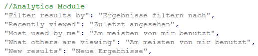

How to Create a Dictionary
- Go to the directory <SmartHub_install_dir>/js/cultures/.
- Make a copy of file en.smarthub.js.
- Change the first two letters (en) with you language.
For example, de.smarthub.js. - Open your new file and translate every label from the file.
- Save the file in the directory <SmartHub_install_dir>/js/cultures/.
Example:
