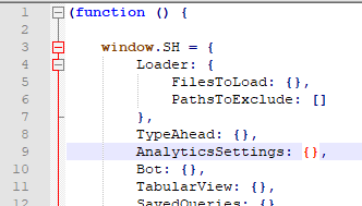

- Copy the
logLevelparameter and value into your custom settings file such as ResultsCustomSettings.js in the "AnalyticsSettings" section (see below).
For more about using custom settings files, see How to Use the UI Editor.
