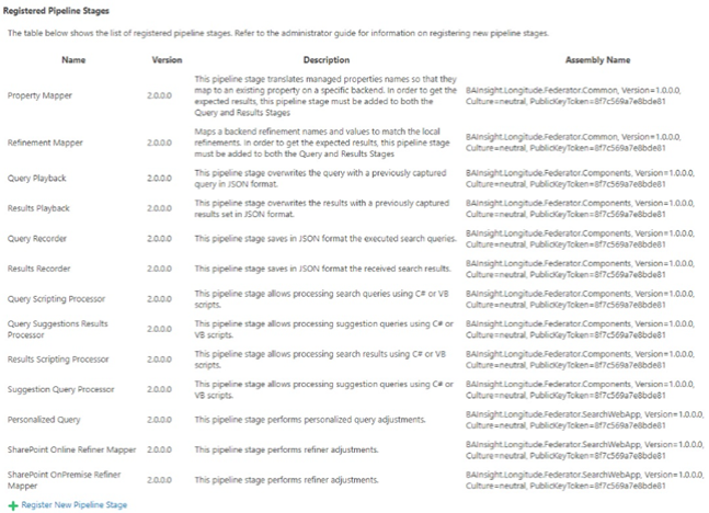

  2. OpenRegistered Pipeline Stages and click Federator Settings
    1. The Properties for Federator SSA page appears. See the Registered Pipeline Stages graphic below.
      See the Registered Pipeline Stages.
  3. Register New Pipeline Stage: Scroll down and click.
    The Federator Search Service Application settings appear.

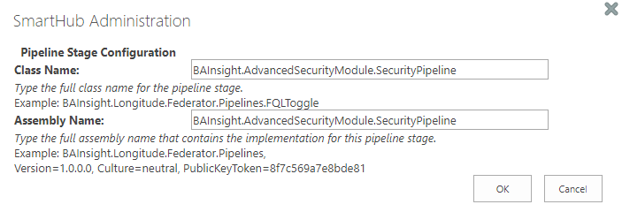

  4. Federator Pipeline Stage: Add the following values:
    • Class Name: BAInsight.AdvancedSecurityModule.SecurityPipeline
    • Assembly Name: BAInsight.AdvancedSecurityModule, Version=1.0.0.0, Culture=neutral, PublicKeyToken=8b346c7a0df406fd
  5. OK: Click OK to see the SmartHub Administration page.
