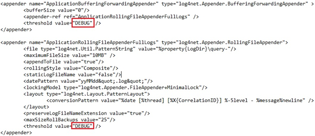

How to Change the Log Level
  1. Use a text editor to modify the FederatorLogger.config file in your SmartHub folder.
  2. Change all of the threshold values from WARN to one of the following levels:
    • INFO
    • ERROR
    • DEBUG
 See the DEBUG log level.
