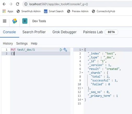

Use the following steps to initialize Kibana v8.x:
- Go to your Kibana Dev Tools.
- URL (or similar): http://localhost:5601/app/dev_tools#/console?_g=()
- Enter this command and run it:
PUT test/_doc/1

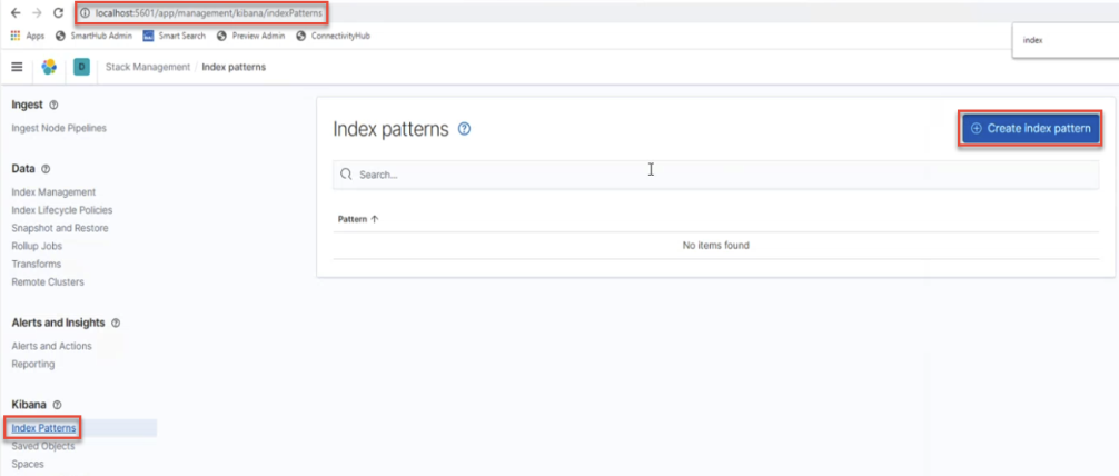

- Open Stack Management → Index Patterns:
- URL: http://localhost:5601/app/management/kibana/indexPatterns
- Create an index pattern based on index:
- Click "Create Index pattern."
- In the Index Pattern text box, enter "test". NOTE: The field is case-sensitive.
- Click the Next step button.
- Click "Create index pattern"

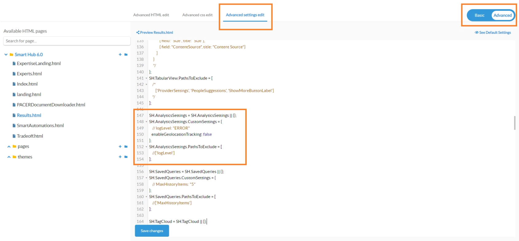

How to Modify the Analytics Settings
To modify the analytics settings, you need to access the UI Editor. For more information, see How to Use the UI Editor.
Select the page that you want to add/modify the analytics settings for.
Select the Advanced mode.
Select the Advanced settings edit tab.
Locate the analytics settings section around line 147.
Add/Modify your setting(s) under the SH.AnalyticsSettings.CustomSettings block.
Note: When clicking on the See Default Settings button from the upper right corner, a new tab opens that displays all the default settings for the SmartHub modules.Locate the analytics settings section to see the default values that are used to control how analytics behaves on your web page.
Save changes.
In the example below, a custom setting is added to disable the GeolocationTracking option.
